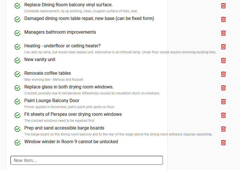

I have installed the new version, and it works well.
Instructions were clear and easy to follow. Comments now show, as do dates (although they are faint). No dates were set on the list shown below.
Only problem I have is that the comments do not have line wrapping, so I have to make the card quite wide. This is up to me to manage - not something that is required for the card.
Many thanks for your hard work.
