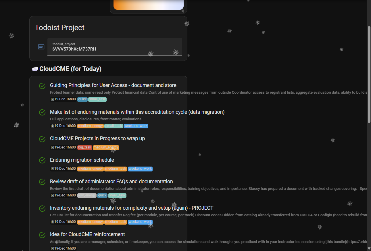

It took me a little while to get the new configuration up and running (despite your excellent migration instructions) because I use the card both in a swipe-card configuration on one dashboard, and as a single card that updates dynamically based on a chosen project on another dashboard. [The following is for others who may have a similar setup.] The new ‘resource:’ line instead of ‘project_id’ in the sensor config did not like the use of an input_text sensor. Then I discovered resource_template, and it works like a charm. (Now I just need to map friendly names to project id’s.) The card updates within seconds of changing the project ID.

Here’s a preview:
Like another user observed, there is definitely an issue with word wrapping, though, as you can see above. I tried the card in both a Masonry-style and Section-style views with the card set to full width. This is not a problem for the majority of my projects, so I chose this extreme example to demonstrate. As a result, I have to scroll ALL the way over to the right to read the text or find the delete icons.
Is it perhaps a configuration error on my end, or do I just need to start using shorter comments in Todoist? :slight_smile:

I made a new release (v1.1) today to fix this. Now item descriptions wrap.
