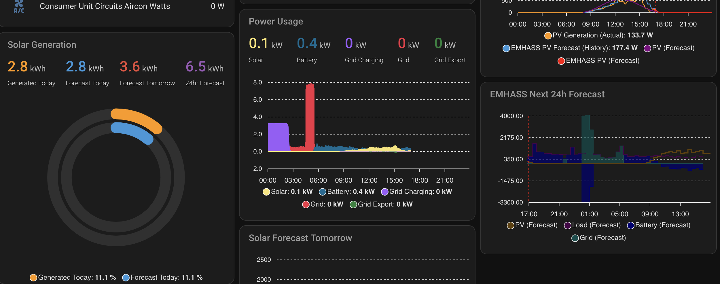

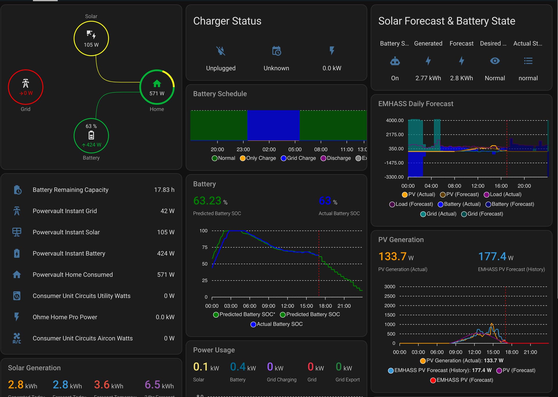

This is my Power dashboard:
The graphs are as follows:
  • Power Flow Card Plus integration to give me the realtime status.
  • Battery Schedule - Derived using the schedule from EMHASS plus any overrides that my templating adds
  • Battery - This is the state of charge forecast along with the actual value since midnight
  • EMHASS Daily Forecast - Visualises the power allocation for the rest of the day, as well as showing the actual values once the time has passed
  • PV Generation - Pretty obvious, reads the forecast and shows actual generation
  • Solar Generation - This isn’t much use, it just shows the numbers for solar.
  • Power Usage - This is a replica of the graph in the powervault portal showing where the power has been sent throughout the day

Battery State Change automation
This is where the battery actually gets set to the various states by setting the select.powervault_charge_status entity to the desired value. There’s a lot of logic around it, and this is where I force charging if there is a free electricity session. Like above it could probably be streamlined, but it’s working and I don’t want to break it :slight_smile:
It triggers whenever the templated forecast variable changes due to some change from EMHASS, if the car starts charging (which is a simple check whether the Ohme is pulling > 500W), or if the free session calendar event starts or ends.
I won’t go into detail about this, as I think if you import it into HA then it’s readable and you can follow the logic. There’s obviously specifics to my situation, e.g, if the car is charging (e.g. in the middle of the day) and there’s not already a forecast planned, and if the battery is low already, then take advantage of the cheaper power and also charge the house battery.
