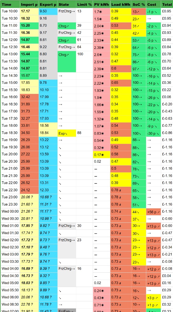

The inverter had been put into Backup mode by predbat at 10am, and was discarding all of my excess solar while importing from the grid to charge the battery. I just verified this by looking at my Octopus account data for Tuesday morning, when it was happening. It showed grid imports >1kW between 10-11am, but exports <0.02kW, despite the fact that >2kW of excess solar was being generated throughout that period.
I attach a copy of the predbat plan for that period.
