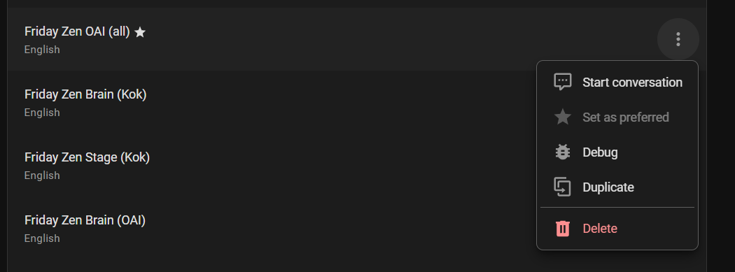

What does your voice debug log for that assistant say:
Under Voice Assistants >
Assist >
Pick your agent
Select the three dot vertical ellipsis menu to the right >
Click it for the dropdown >
Select Debug…)
