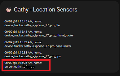

For testing I set up some dashboards that I used in the past, for example for the same phone above, I have:
The one in the red rectangle is a combination of the others, as shown in the first picture, and is the sensor you use to act upon her being home or not home.
Once you have something like the above dashboard for testing, it's a simple thing to get in the car with your phone and drive 5 minutes away and just wait to test it, verify that once they all change to "not home" that the person changes to "not home", then go back home and see how quickly one of those sensor changes to make the person sensor also immediately say you are home. As mentioned before it is designed such that the person is considered not home only after ALL of the person related sensors have changed to not home, and then when you arrive back home as soon as any one of them changes to you being home then the person sensor will see you as home. Hope this helps, here is the source code for that dashboard card above for testing (note I renamed all the sensors that were working for each to a name that made sense once I dug up which were which). It's alittle bit of an excercise to update all of this when either of us gets a new phone! Note in the source code the above card is also using card-mod to make the text smaller so it is more convenient on a cell phone display, you can just remove that "card_mod:" section from the source code if you don't want to install card-mod... Note - I just changed this source code here, I now use "last_updated", not "last_changed" - for instance the GPS may be updated hundreds of times while the person is home all day, you want to know the last time it was updated (you could use both if you wanted....)

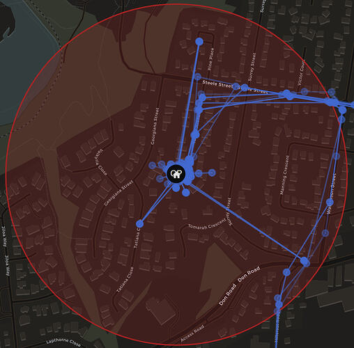

My GPS location was working for years and now recently has been throwing GPS scatter outside the original 50m home zone. (Some change has happened)

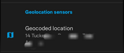

My initial solution was to open up Google Maps on the phone which seemed to bring it back to my home zone. I found the geocoded location was positioned 350m away.
I have now increased my homezone to 380m which encapsulates the scatter seen in the below image.

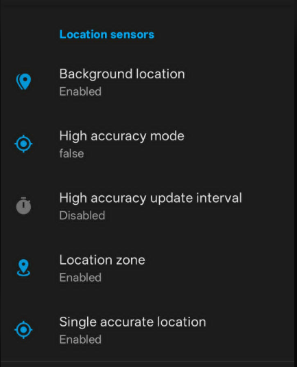

Sensors Enabled though companion app settings
Geocoded Location
  • Sensor enabled
  • Update with location sensors ON
  • Minimum accuracy 200m
Background Location
  • High accuracy OFF
  • Location sent Exact
High accuracy mode
  • Sensor enabled
High accuracy update interval
  • Sensor disabled
Location Zone
  • Sensor enabled
Single Accurate Location
  • Sensor enabled
  • Include sensor in sensor update ON
  • Minimum time between updates 60000 milli seconds
Android settings for Companion App
Permissions
  • Location Allow all the time
  • Manage app if unused disabled
Battery usage
  • Allow background activity
  • disable any battery optimizations for the app
Has been working as it should now, I only use GPS position.

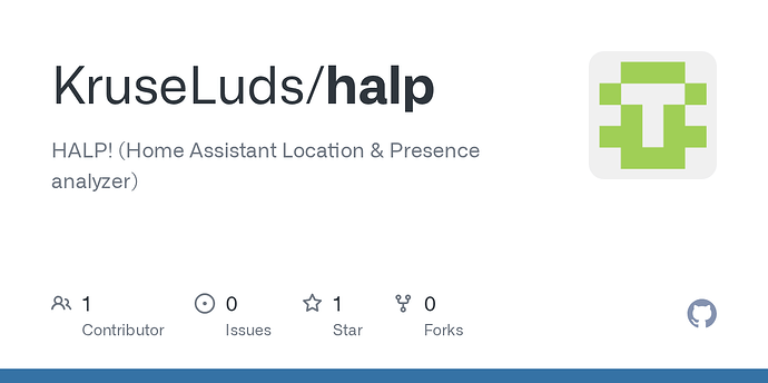

I just created a new integration to help people with this! Hot off the presses! Enjoy!
