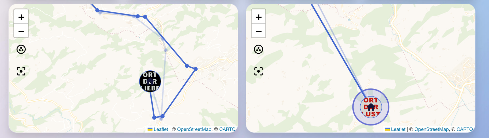

Not sure what you mean, as far as maps go I am only using in ui_minimalist, this kid of card which says "Home" or "Away" and when I click on the card is shows me a little map of the position:
 - type: horizontal-stack
    cards:
      - type: 'custom:button-card'
        template: card_person
        entity: person.firstname_lastname

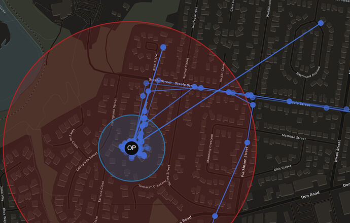

hours_to_show: on the map card, gives you a visual history of gps points. Helps identify erroneous GPS points.
I have this setup as a admin only full panel dashboard.

KEWL! How do I get this?
It is the native map card. code in the above post.
Thanks to @Chykan .
It is integreated now.

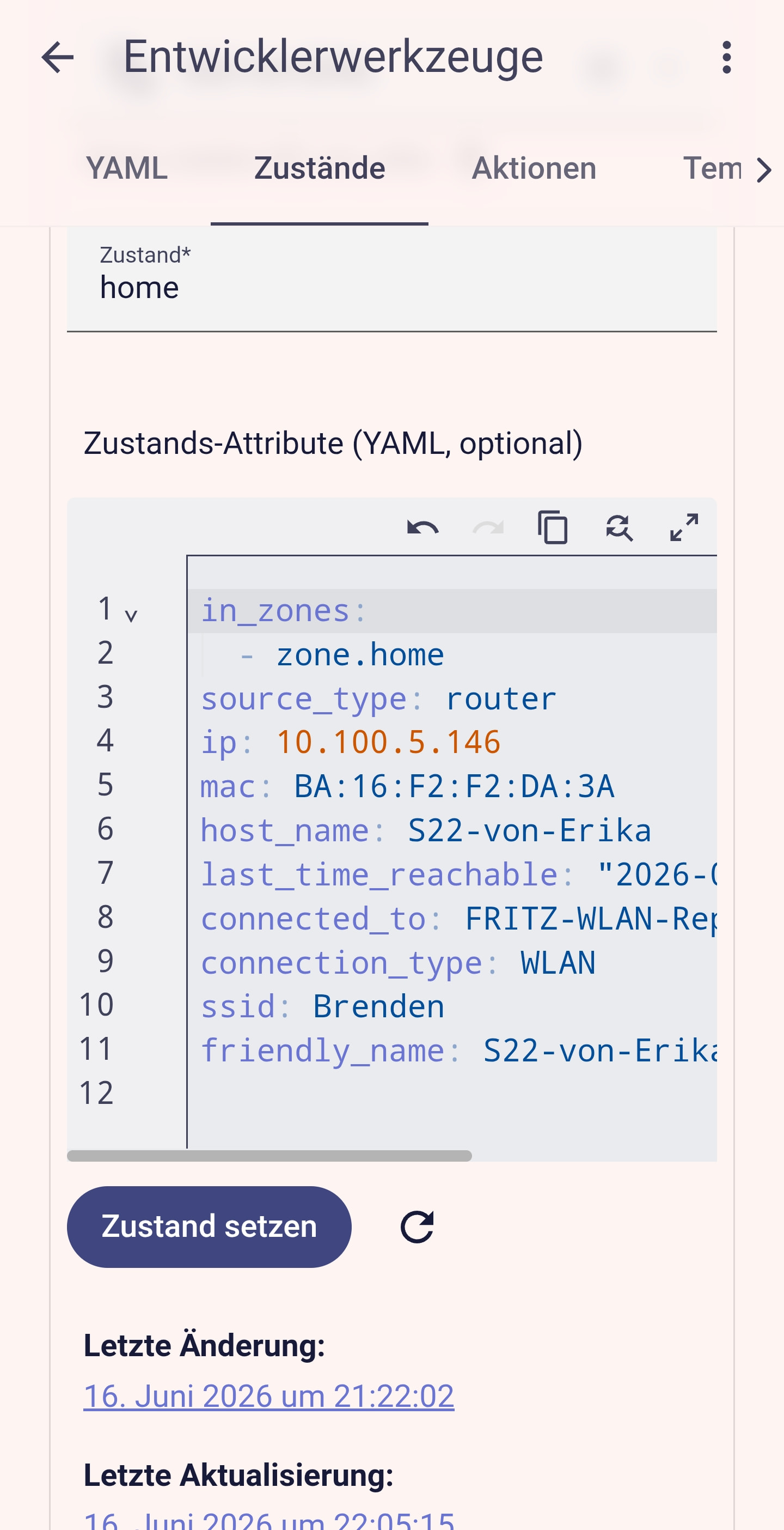

My wife left half an our ago.
Router is correct. GPS stays at home.
What can I do?
I can't just tell my wife, “You have to open the app regularly.”
I just don't get it.

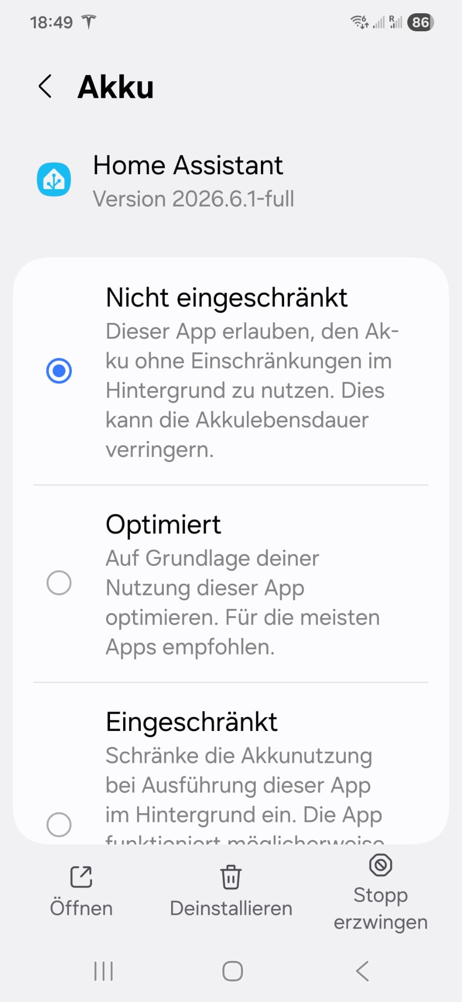

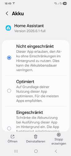

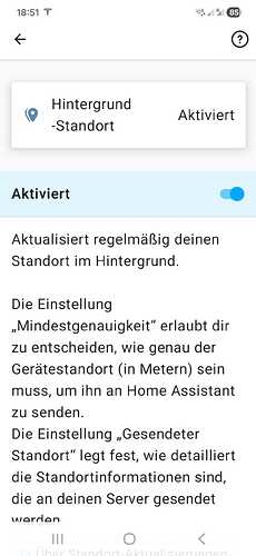

You have checked all battery optimisations are turned off for the HA App?
Does she have an Android phone?

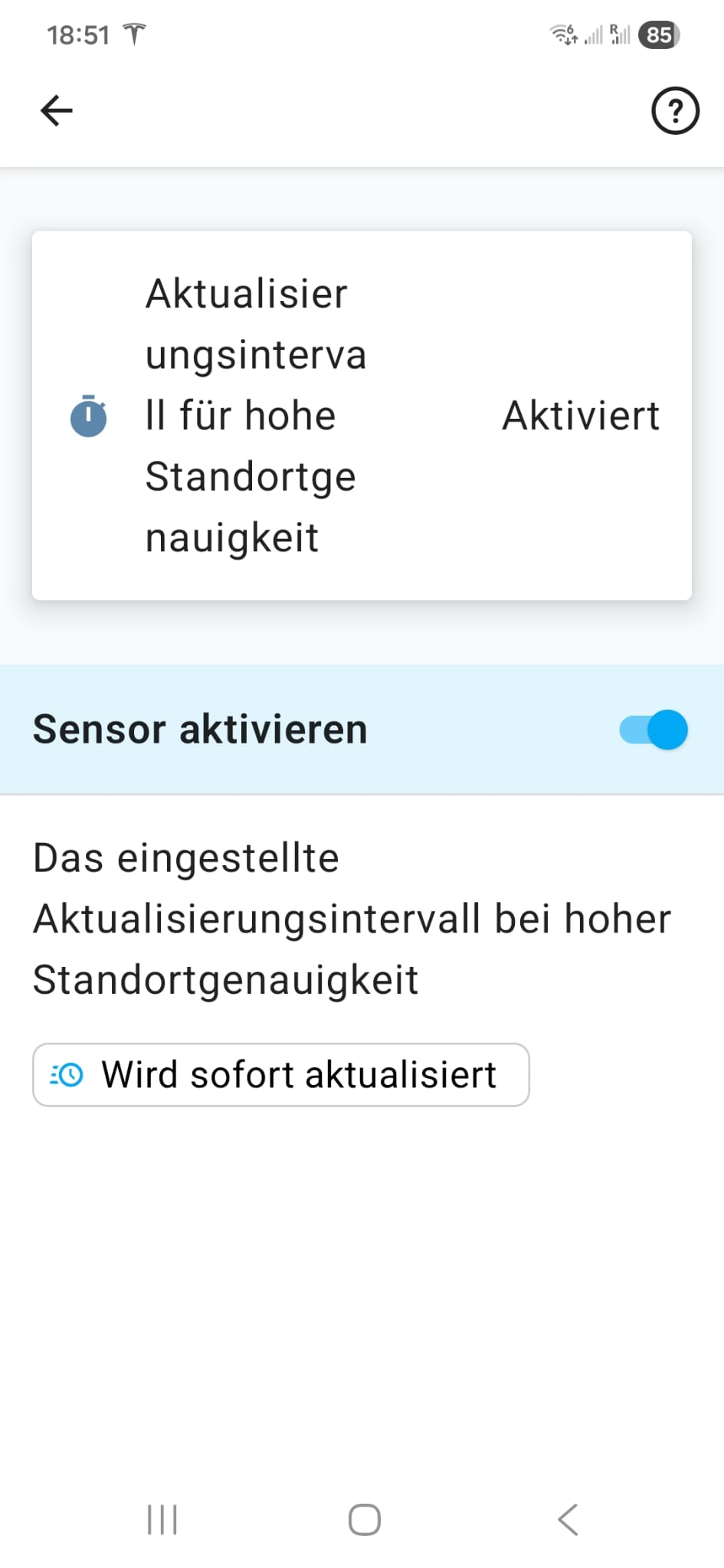

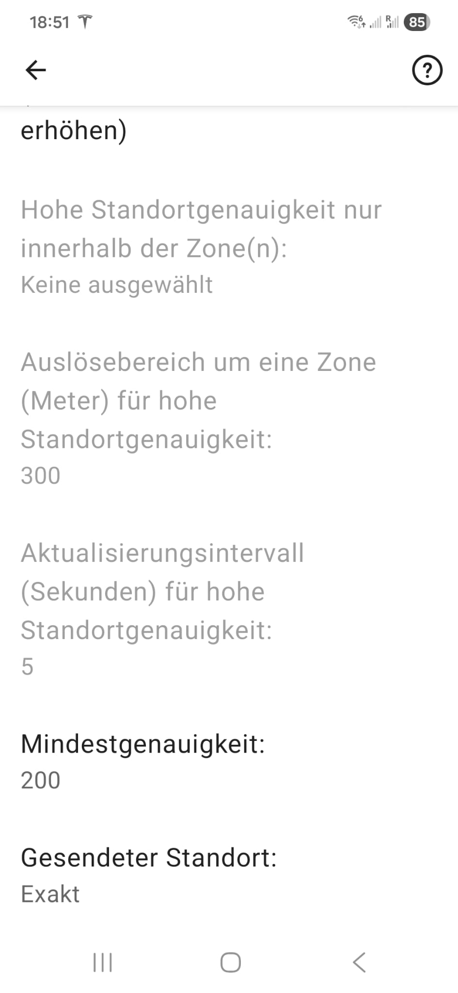

What is your update frequency for your location sensors?
What is your minimum acuracy?
Is "update with location sensors " active for geocoded location?
Is "include in sensor update" active for single accurate location?

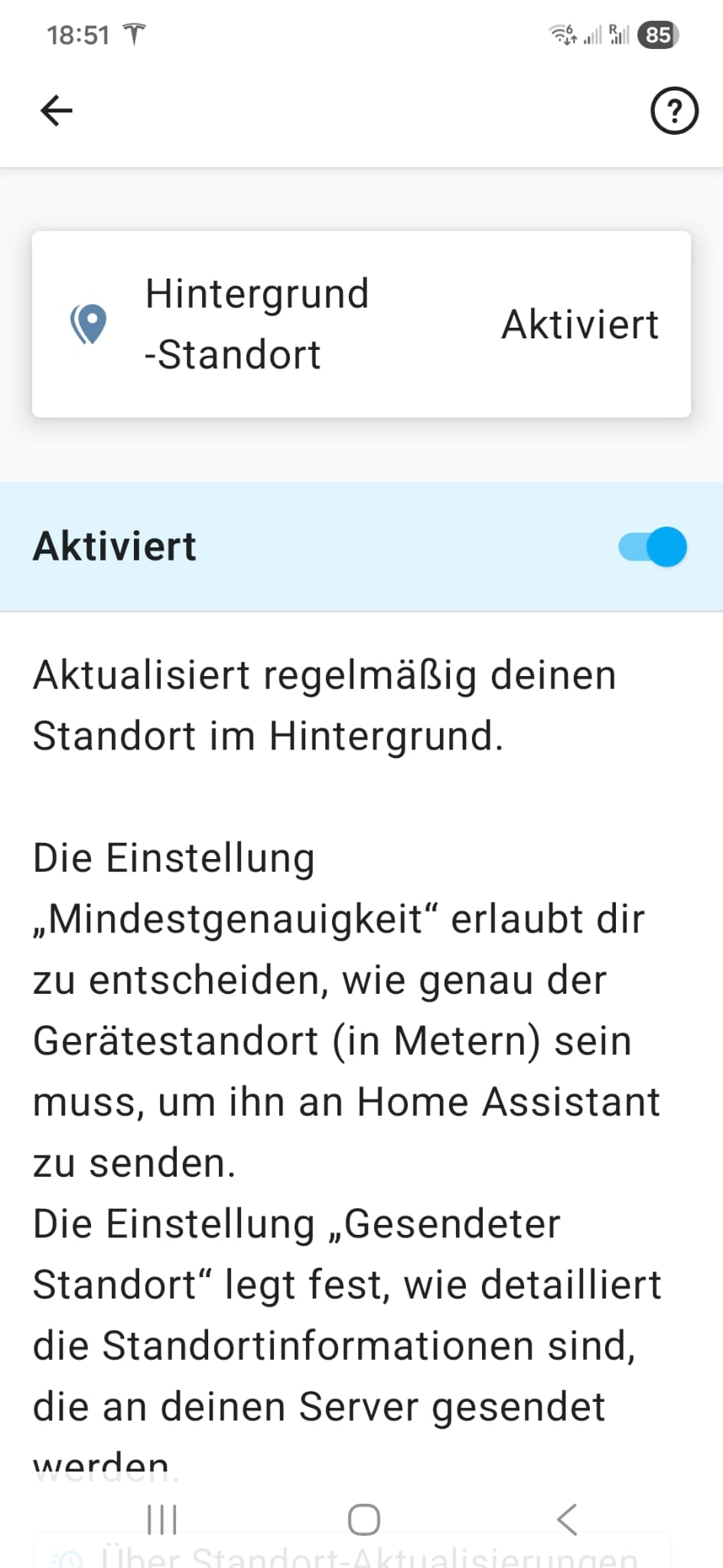

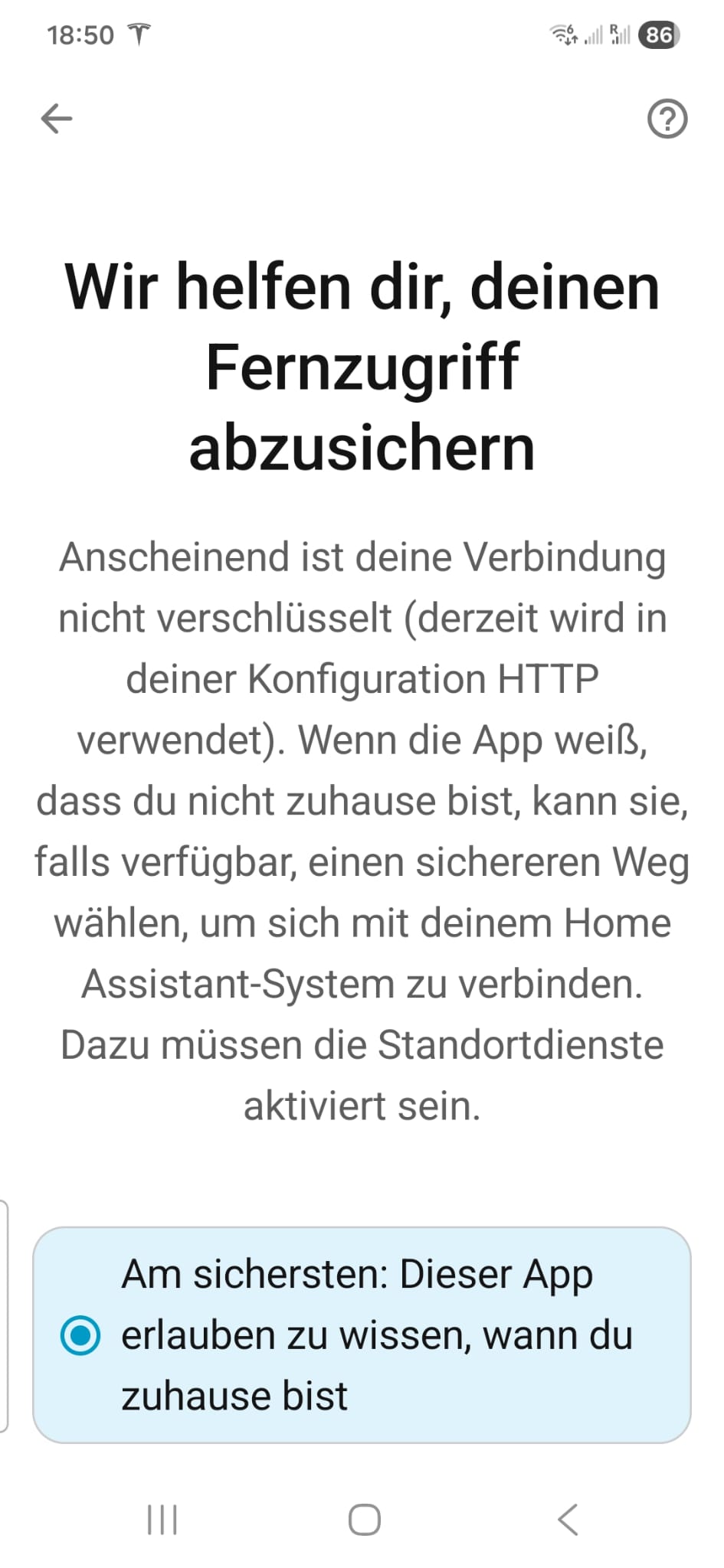

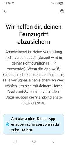

Can you please share a screenshot of the settings OUTSIDE the companion app? Settings -> Apps -> Home Assistant -> Location
Can you also share a screenshot of her settings within the app.
Settings -> Companion app -> Location
I verified again everything. And the settings are the same as on my phone.

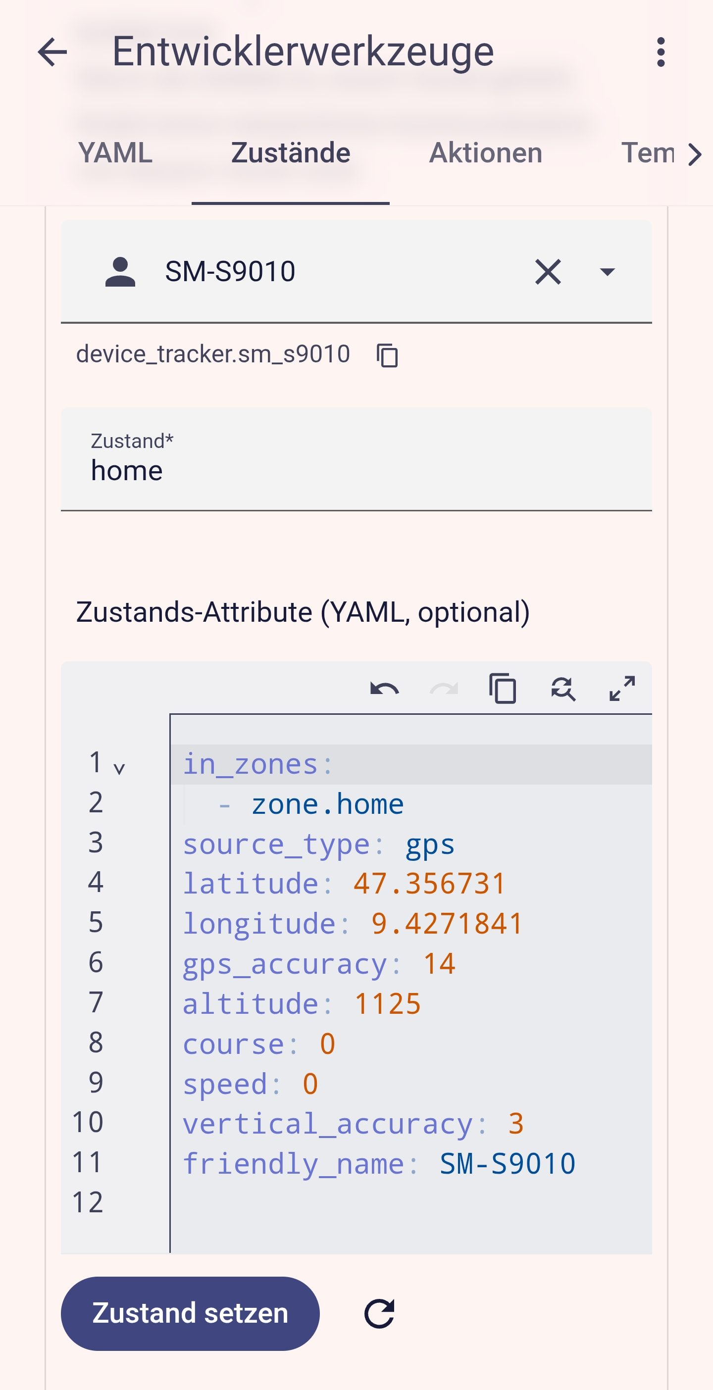

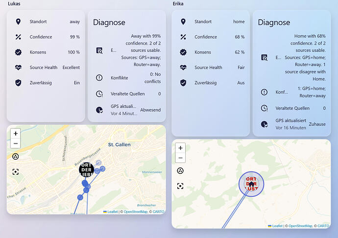

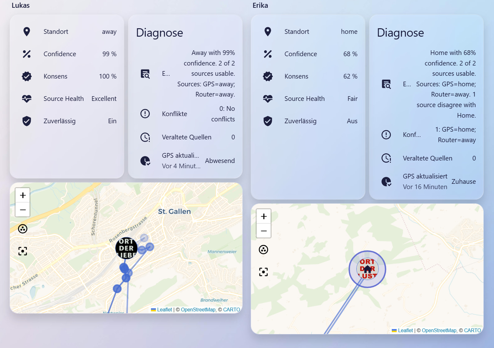

We just drove home together. Erikas mobile updated only when we were at home.
Mine is updatin much more often. But why?

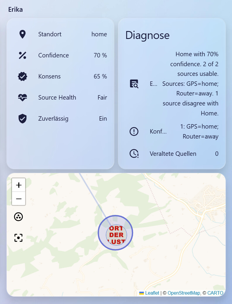

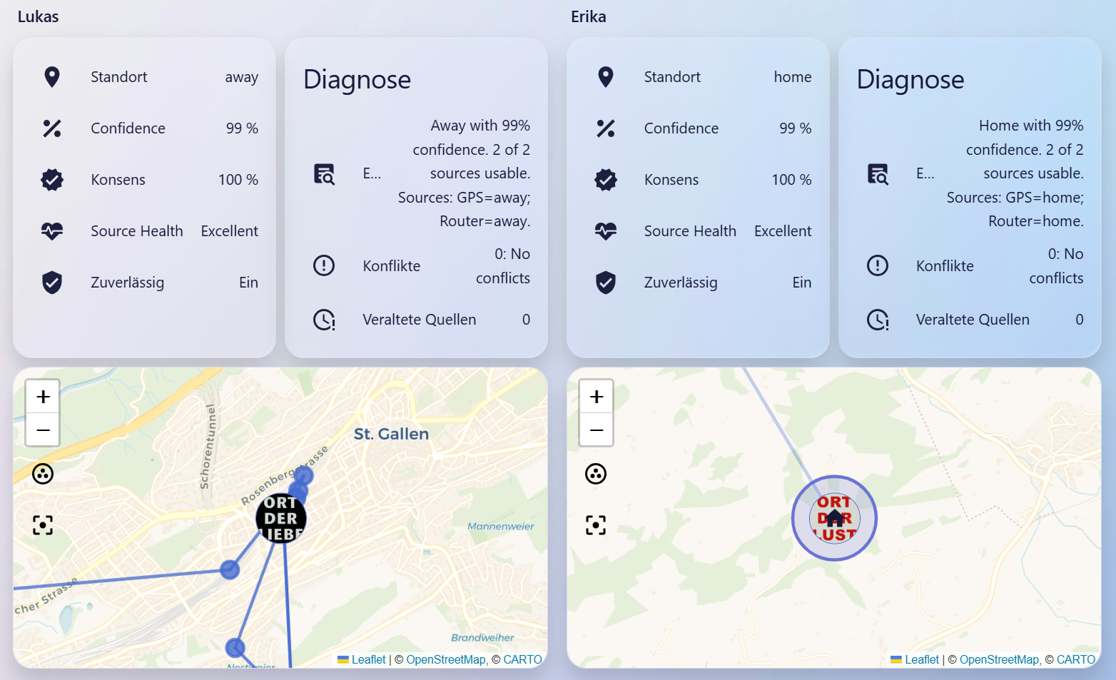

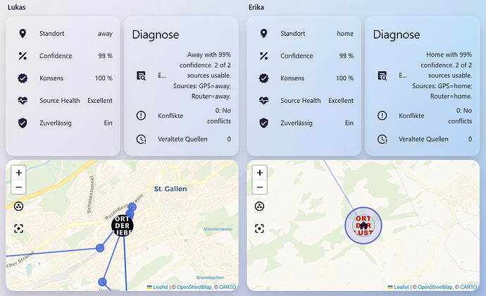

Can you please share your configuration for that map card you have displayed? Maybe there's a different approach. Please do not alter the configuration of that card, show it as-is.
  - type: sections
    max_columns: 4
    title: Diagnose
    path: diagnose
    icon: mdi:help-network
    sections:
      - type: grid
        cards:
          - type: vertical-stack
            cards:
              - type: heading
                heading: Lukas
                heading_style: title
              - type: grid
                columns: 2
                square: false
                cards:
                  - type: entities
                    entities:
                      - entity: sensor.halp_lukas_metzler_vetted_location
                        icon: mdi:map-marker
                      - entity: sensor.halp_lukas_metzler_location_confidence
                        icon: mdi:percent
                      - entity: sensor.halp_lukas_metzler_consensus_score
                        icon: mdi:check-decagram
                      - entity: sensor.halp_lukas_metzler_source_health
                        icon: mdi:heart-pulse
                      - entity: binary_sensor.halp_lukas_metzler_location_reliable
                        icon: mdi:shield-check
                  - type: entities
                    title: Diagnose
                    entities:
                      - entity: sensor.halp_lukas_metzler_location_explanation
                      - entity: sensor.halp_lukas_metzler_conflict_details
                      - entity: sensor.halp_lukas_metzler_stale_sources
                      - entity: device_tracker.sm_s9080
                        name: GPS aktualisiert
                        icon: mdi:clock-check
                        secondary_info: last-changed
              - type: map
                entities:
                  - entity: person.lukas_metzler
                  - entity: zone.home
                hours_to_show: 24
                theme_mode: auto
                aspect_ratio: "16:9"
      - type: grid
        cards:
            cards:
              - type: heading
                heading: Erika
              - type: grid
                columns: 2
                square: false
                cards:
                  - type: entities
                    entities:
                      - entity: sensor.halp_erika_inauen_metzler_vetted_location
                      - entity: sensor.halp_erika_inauen_metzler_location_confidence
                        icon: mdi:percent
                      - entity: sensor.halp_erika_inauen_metzler_consensus_score
                      - entity: sensor.halp_erika_inauen_metzler_source_health
                      - entity: >-
                          binary_sensor.halp_erika_inauen_metzler_location_reliable
                  - type: entities
                    title: Diagnose
                    entities:
                      - entity: sensor.halp_erika_inauen_metzler_location_explanation
                      - entity: sensor.halp_erika_inauen_metzler_conflict_details
                      - entity: sensor.halp_erika_inauen_metzler_stale_sources
                      - entity: device_tracker.sm_s9010
              - type: map
                entities:
                  - entity: person.erika_inauen_metzler
                  - entity: zone.home
                hours_to_show: 24
                theme_mode: auto

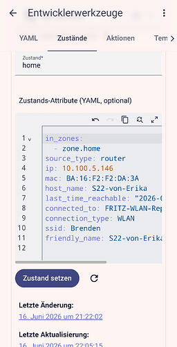

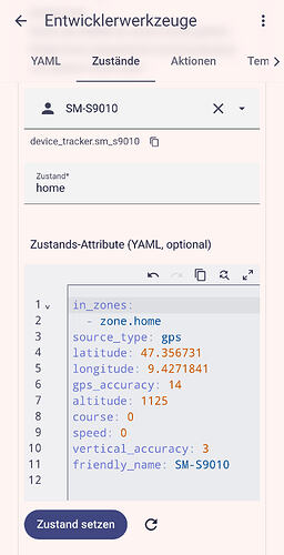

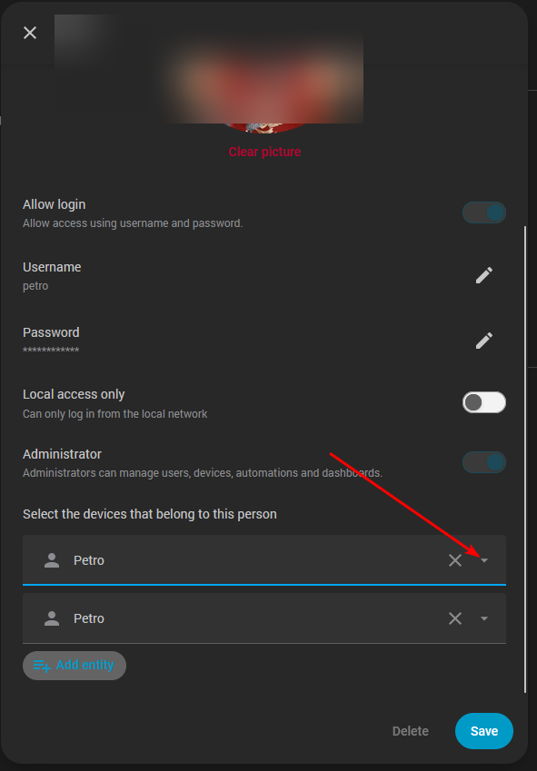

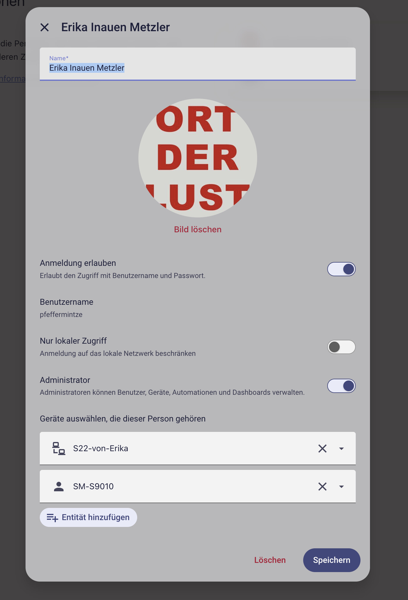

Ok, thanks for that. Can you please go to her person in Settings -> People -> Then click on her person. Scroll down to the bottom and take a screenshot of each entity expanded. You have to click on the arrow like this:
Take screenshots of each entity in that list expanded
Yes, I want you to expand those entities to show the ID's
@Brendianer did you turn on all the location poermissions settings etc. such as high accurtacy mode and updatre interval etc.?
BTW I just posted an update to my HALP! integration listed above...
Yes. More I cannot find...

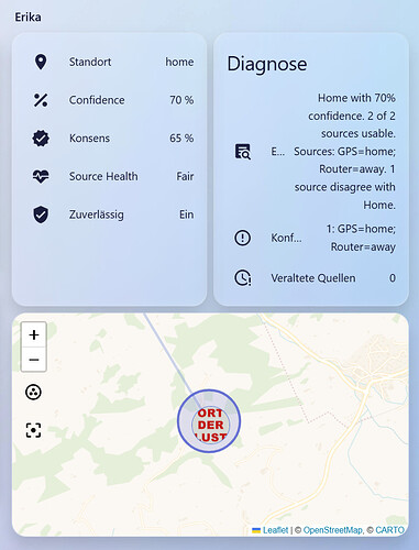

Expanding does not help.
But here they are...
All!
I do not find more..,.
