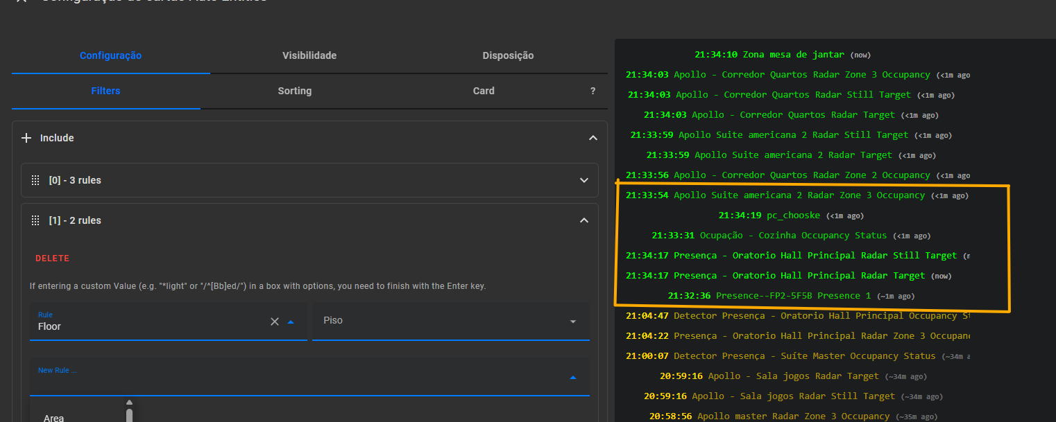

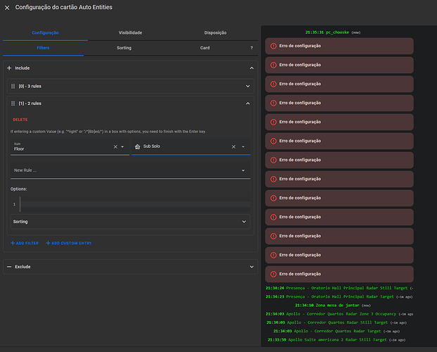

I really liked the idea of the card, but I wanted to be more flexible with filters.
Like filter based on area, floor etc…
To choose what I want to see on the list.
I tried auto entities because is more flexible but I noticed that is bugged.
Without filter:
Filtering floor:
I dont know why this happens :confused:
This is not designed to be used with auto-entities. I am a big fan of auto-entities, but in this case I couldn’t figure out how to make it work, and it also would provide no benefit here (for me personally).
Thinking about it, I don’t think this can ever work purely with auto-entities unless it’s possible to get the list of entities from auto-entities into a variable in the ‘label’ field. If someone knows how to achieve that, let me know and I will make it compatible with auto-entities. I would prefer that as it’s more standardized and user-friendly.
This is technically more flexible though, because the code is just creating a list of entities. You can use any code you want to create the list of entities.
