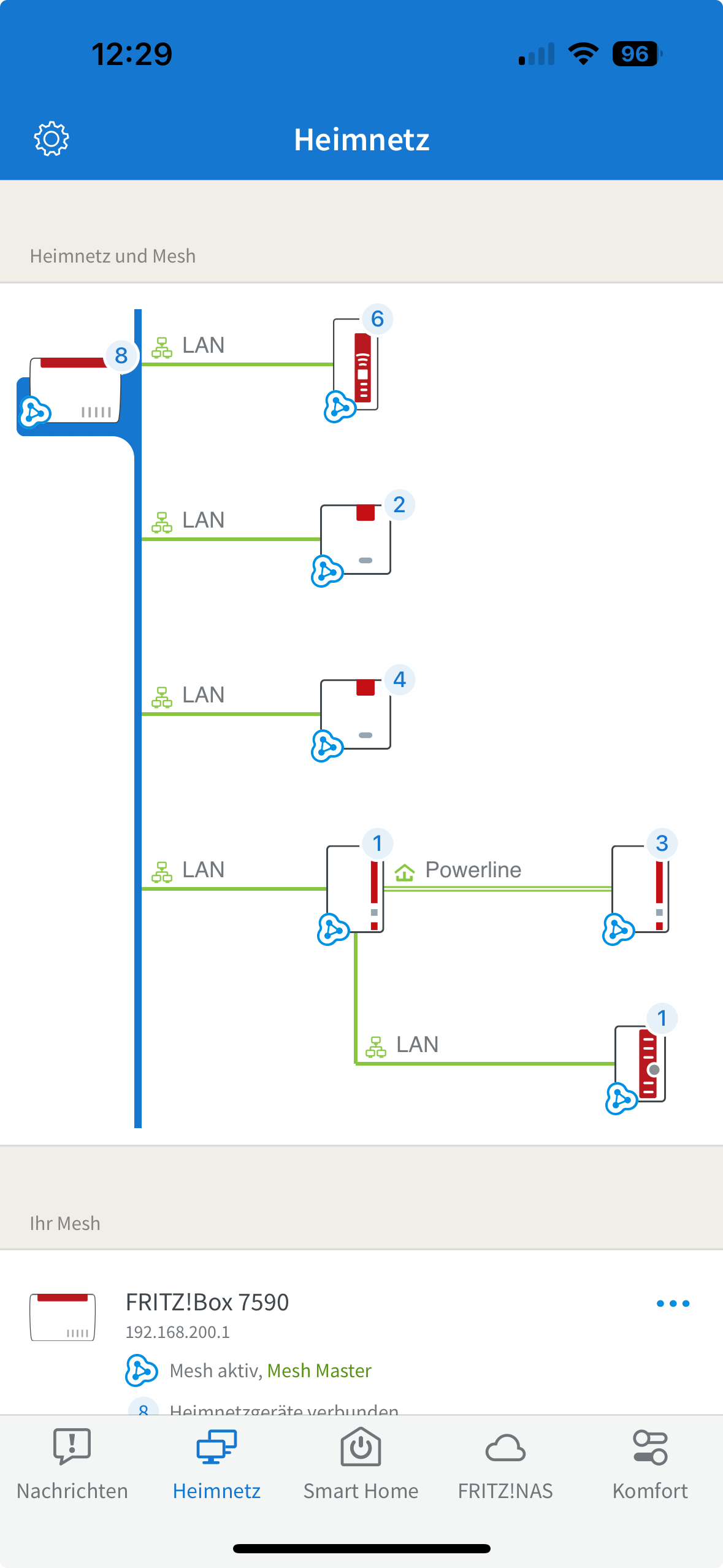

Yes, I am sure. Here is a screenshot of my network. I have also only my main router integrated but unfortunately can’t track the devices in the mesh routers.
