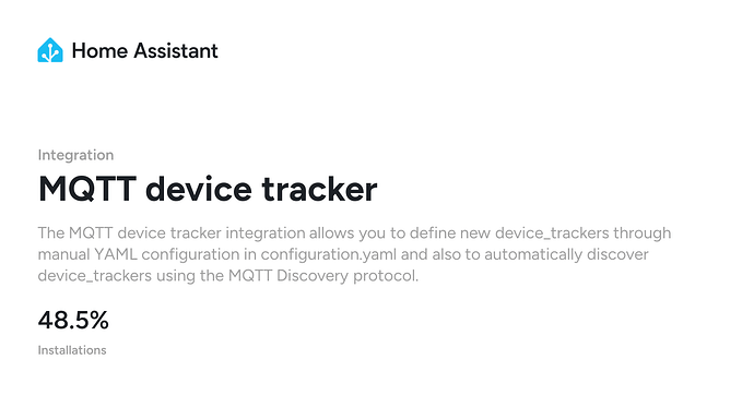

I believe that action has either already been removed, or is scheduled to be removed. The same goes for the underlying known_devices.yaml file it relies on.
Those should be configured under the mqtt integration, not the device_tracker integration.... see the examples in the docs:
There is now the option to create device_tracker entities through the template integration. If you want them to update based on MQTT, you would just include an MQTT trigger and you could add other triggers if needed.
Trigger-based Template Entities
Not removed, just deprecated.
We have 11 months left...
The legacy device tracker platform bluetooth_le_tracker.device_tracker is being set up; legacy device trackers are deprecated and will be removed in Home Assistant Core 2027.5, please migrate to an integration which uses a modern config entry based device tracker
