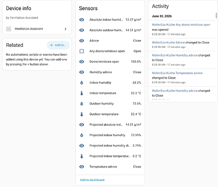

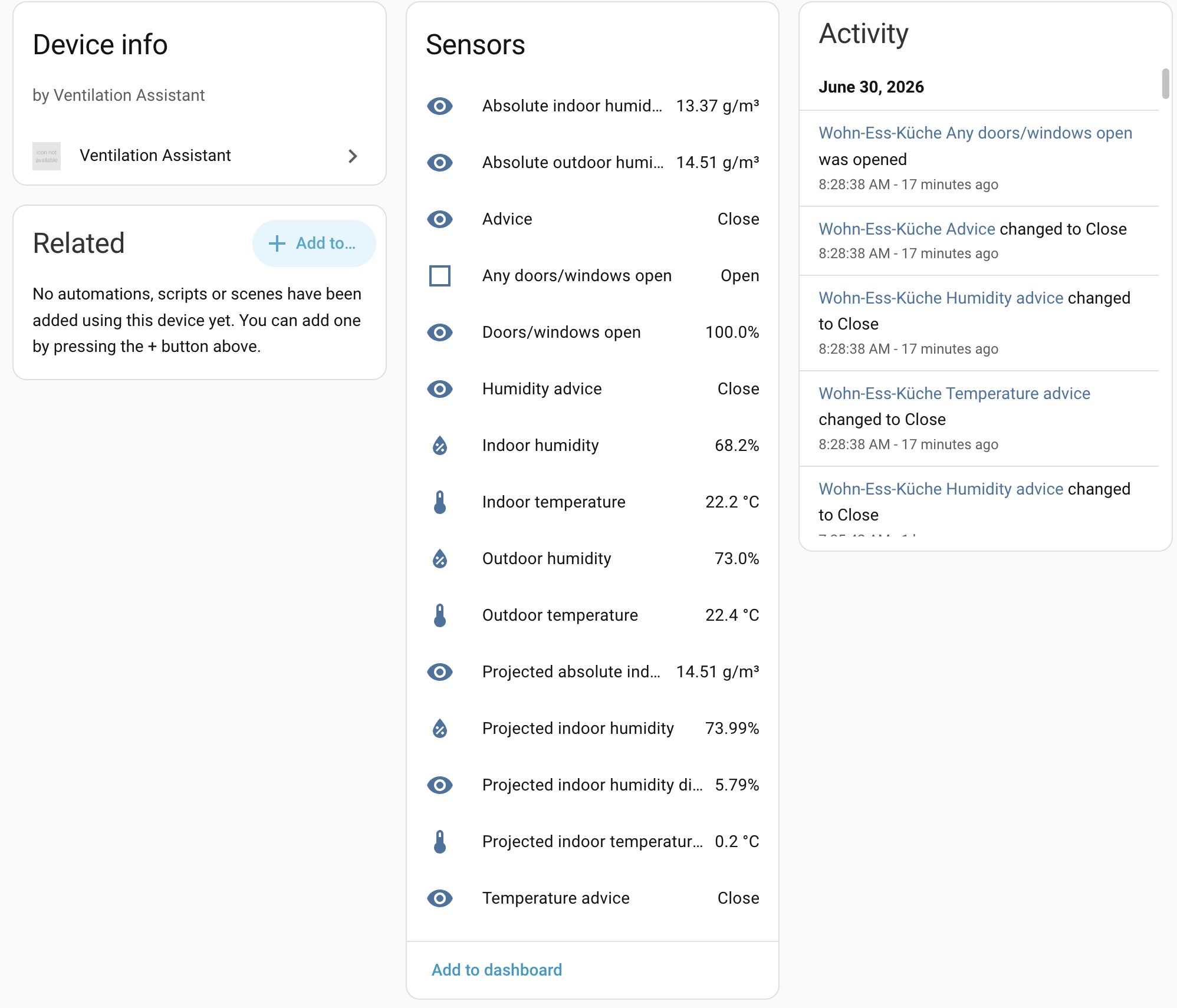

Screen shot
What the generated device looks like in HA:
How I use it
I have a dashboard for showing the temperature and humidity values for each sensor, organized by area (room). On this dashboard I now also include the computed entities for "Projected indoor temperature difference", "Projected Indoor humidity difference", and the "Advice".
