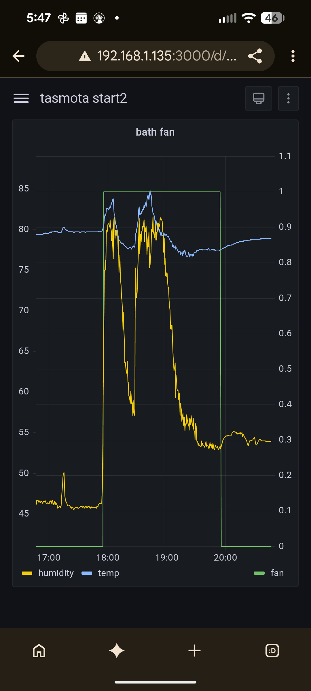

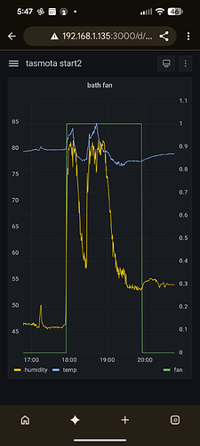

I have my sensor in the fan which is right above the shower. I first starter with complicated automation that looked at temperature rise and humidity rise. I didn’t like the response, since it lagged too much.
I ended up simplifying it. Now it is if the relative humidity is above 70%, the shower is started, turn on the fan. It leaves the fan on till the humidity drops to 50% or has been stable (within a deadband) for 30min.
This works well. There is also an Echo/Alexa in the room that can turn the fan on.
I added more sensors in the room (that are farther away from the shower) their signal (that the shower is on) is not as clear.
Here is an example of two showers with a small gap between them.
