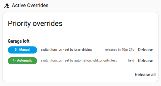

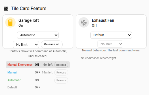

There’s also a tile-card feature (features: - type: custom:priority-feature):
A card listing everything currently held with one-click release:
(“User” is my display name here)

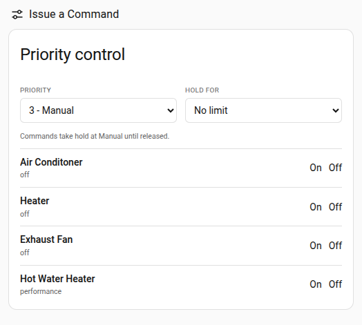

…and a card for issuing commands at a level:

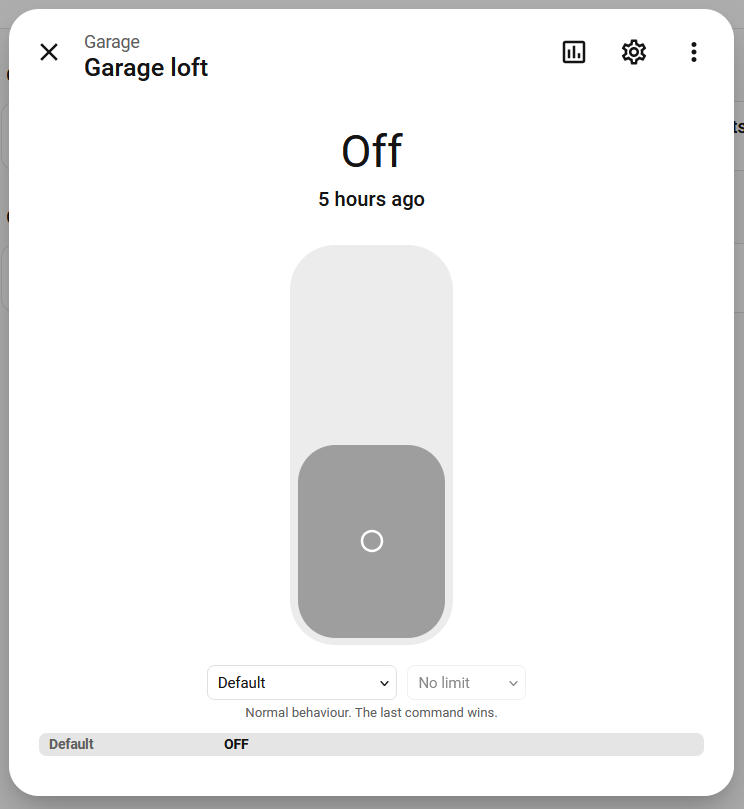

A couple of pictures of the interface in action:
No overrides:

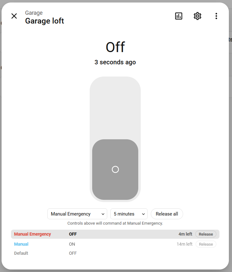

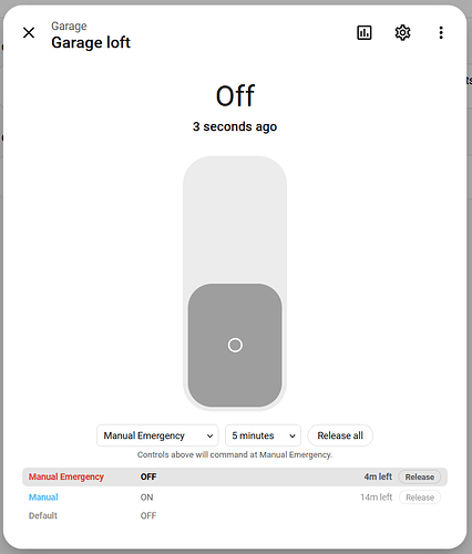

A few overrides:
In this state, the light will be OFF for 4 minutes because Priority 1, “Manual Emergency,” has control. After that 4 minute timeout, the “Manual” override will take over and the light will turn ON. It will stay ON for ~10 minutes, because its override expired in ~14 minutes from this screenshot and the Emergency override lasts ~4 minutes. After being ON for ~10 minutes, the “Manual” override will expire.
Pressing “Release All” will release all overrides and allow the “Default” to fall though, whatever state that may be. Or, you can release individual overrides below.
Overrides without an expiration will never expire, and can only be overridden by another command at the same or higher priority.

At this time, the “priority array,” that is, the list of commands that HA needs to keep track of and arbitrate, looks like this (excuse my incorrect YAML, I’m on my phone at the moment):
priority: 3
priority_ttl: "02:00:00"
service: turn_on
priority: 5
service: turn_on
Then, the automation fires at 10pm, commanding the light off at Default. Now the priority array looks like this:
priority: 3
priority_ttl: "01:50:00"
service: turn_on
priority: 5
service: turn_off
This is where the priority arbitration kicks in. Your command is at a higher priority (lower number = higher priority, think “priority one” meaning highest priority), so even though the automation fired, the light did not turn off. HA only recorded that something wants it off, at priority 5, but that priority didn’t win.
After another hour and 50 minutes, your Manual override expires. At that time, the array becomes:
priority: 5
service: turn_off
HA now evaluates that array and sends the turn_off command to the light. The automation is now back in control and the system is following its orders.
Now, let’s go back in time a little bit. It’s 11pm so your override still has an hour left, but you’re going to bed and go over and hit the physical switch on the light (in this case, I’m assuming the light remains powered and on the network, it just has an off switch you can use on it for local control instead of network control).
HA will see that the state changed, but it’ll also know that it didn’t perform the command itself; something outside of its control did it. It’ll assume that was a human hitting a physical pushbutton and it will not countermand you. It will not re-send the on command; humans should always have final say. The override will continue to live in the priority array until it expires, or a new command lands that has a high enough priority, and only in those cases, would it actually send any command. In this example, the Default level holds the only command (the priority 5 turn off, captured when you turned off the light) and it wants the light off, so it’ll just stay off.
