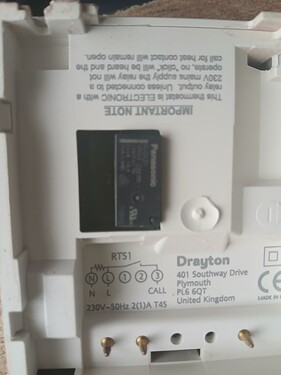

As requested and thanks for the guidance. The timer is a Drayton Lifestyle Single Channel LP111Si I just found its’ programming sheet.
And my bad it’s 3-wire If you can help or need anything more just let me know?
seems like an ‘on/off’ switch only to me. I would almost think you can attach any switch you want and create a proper scheduling/temperature control in HA
To be save, just measure the voltage on pin 3 in ‘on’ state.
Yep, that’s simple relay output which you can substitute with (of put in parallel) any smart relay, Shelly or Sonoff for example.

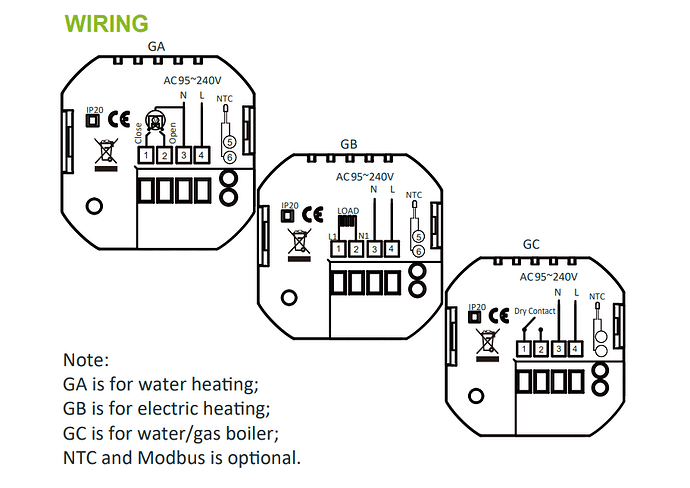

Looking at this one:
https://www.aliexpress.com/item/1005005230261106.html

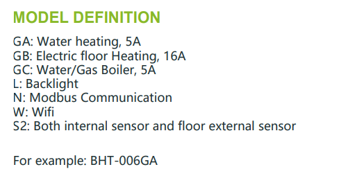

The manual has this:
So GC version seems to have a dry contact relay, not sure what the rating is but that could be what you need. I think.
Perhaps.
5A seems to be the rating.
I assume the switch here is just for “data” and not to actually take the load of your bolier.
So probably will work.
At least it’s cheap enough to test.
First try it without hooking it up to the boiler though, just to be sure noting blows up

interesting device, i would have spotted the GA as the proper one btw.
Your actual thermostat has non-dry contact 230V 1A relay. So virtually any mains powered thermostat with relay output can be used to substitute it.

I believe the GC will work too if the Live is connected to pin 1 and pin 4.
