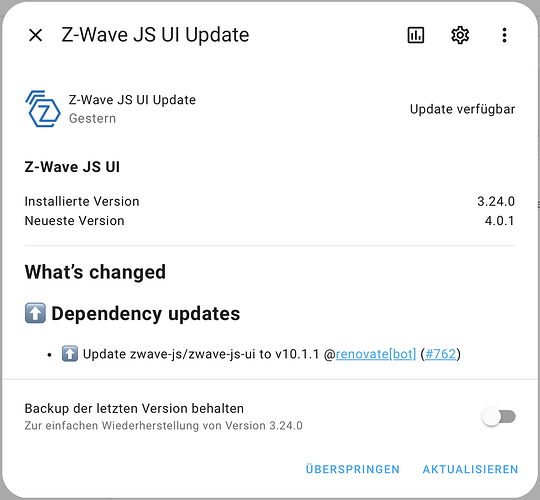

a news - there is obviously a first fix - but I haven’t tried it yet
I’ve had a few rough updates with zwave js over teh past few releases and decided to hold off on this one. I’m now seeing theres a new update. Has anyone tested this to see if it fixes some of teh issues from the 4.0 upgrade?
