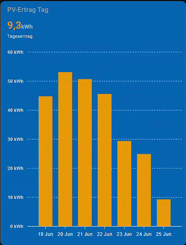

Hello, I need help.
I want to display a chart using the Apexcharts card, which works well so far. However, I would now like to have the values ​​directly displayed as text on the bars, so I need “dataLabels,” as far as I understand. The problem is that I’ve written the code, and the values ​​still aren’t displayed. I only see the values ​​when I hover the mouse over the bar.
I hope someone here can help me with my code.

That option goes in the series config, like this:
series:
  - entity: sensor.hostname_scb_4bed33_energy_yield_day
    type: column
    color: "#e69807"
    group_by:
      duration: 1d
      func: max
    show:
      datalabels: true
