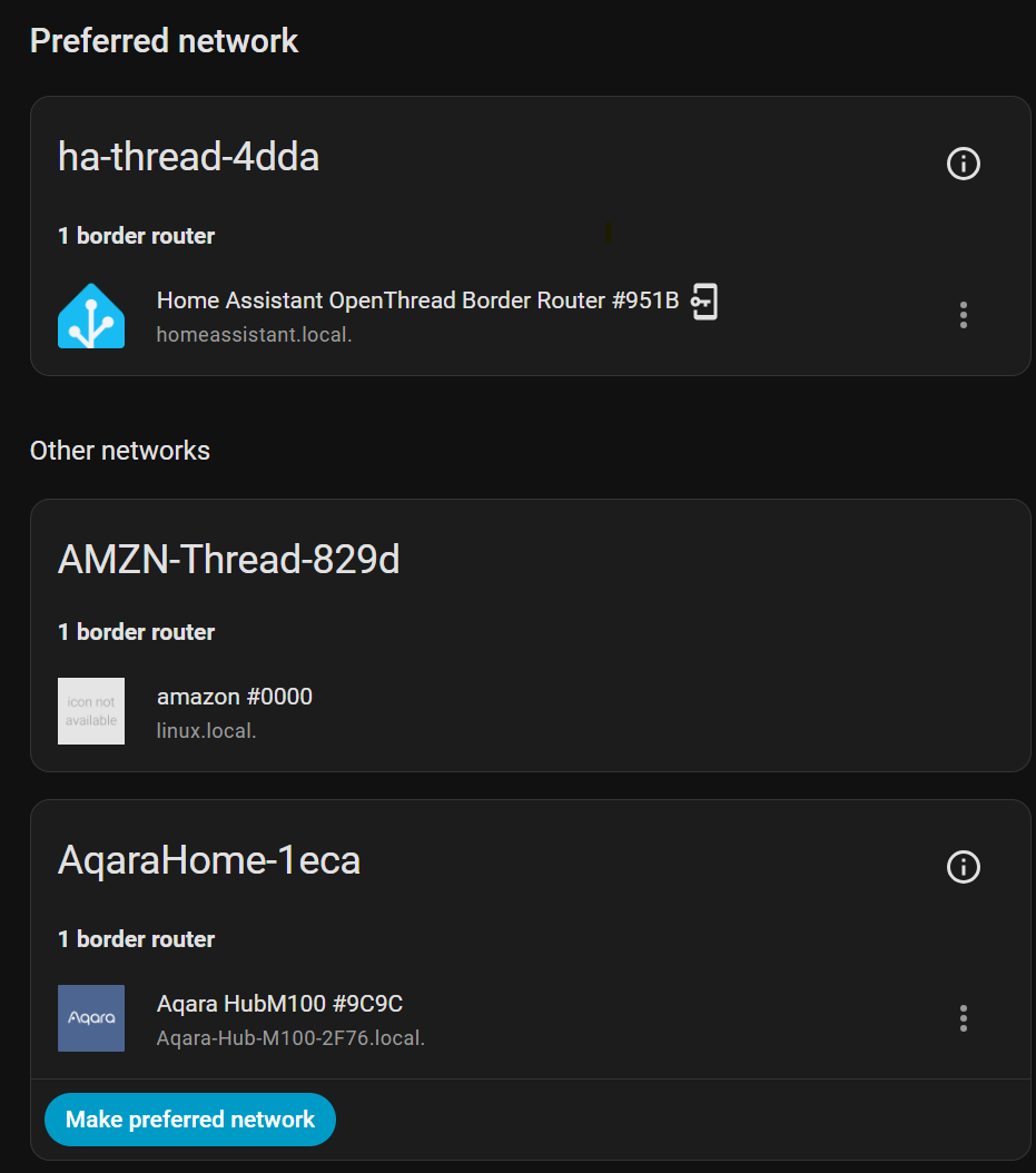

  • there is no other Matter or Thread network

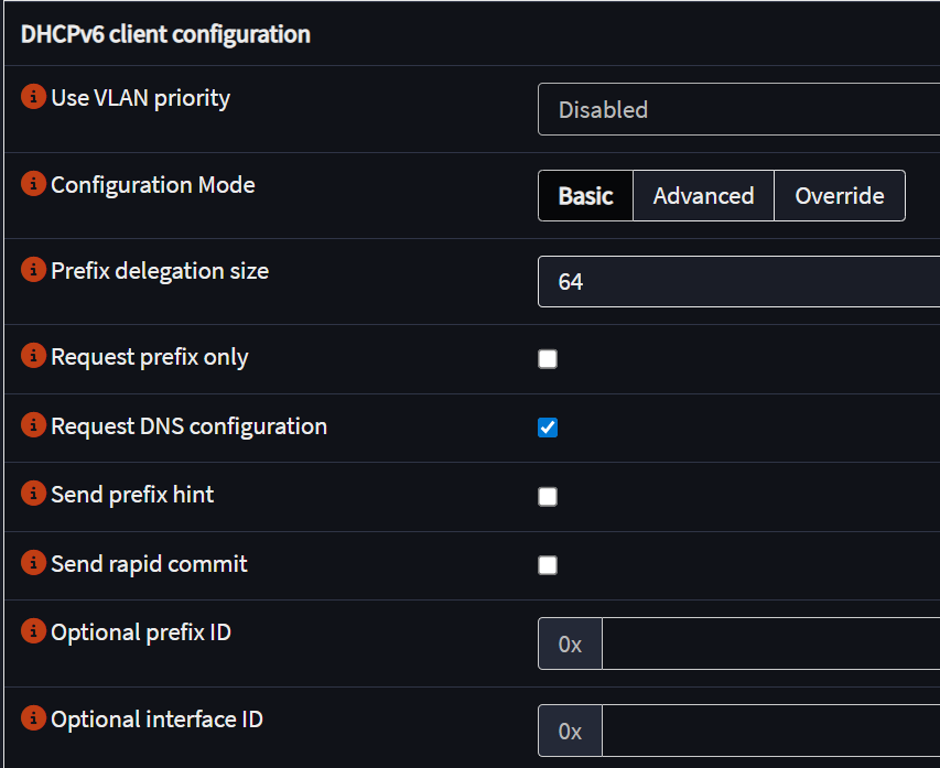

  • my network uses VLANs, I figured out I need to be on the same VLAN with my smartphone, although, it always connects via 5GHz, not 2.4 GHz
  • sometimes I get a pop-up about a Matter device being ready to connect
  • I enabled IPv6 on my opnsense firewall for the network and added a DHCPv6 pool, also set a static IPv6 on Home Assitant, local DNS is only setup for IPv4 though

a) In OPNsense, you just need to enable IPv6 on LAN interface with DHCPv6 selected from dropdown. There is absolutely no need to configure any DHCPv6 DHCP pool. Matter devices use auto-generated IPv6 addresses (as far as I know). I have not configured any DHCPv6 in my OPNsense LAN and WAN interfaces. This is my LAN interface:

Now, in HA, go to Settings → Thread (on right hand side). See if the Thread network is visible. If you have more than one Thread networks, they will also be visible. I have this:
The first one is the OTBR Thread network which I use for all Matter devices and this is the Preferred network. Once the OTBR Thread device is visible, and HA is assigned an IPv6, you should be able to add Matter enabled devices to HA. I do not even scan the QR code for adding a device. I just use the Matter code and it works flawlessly.
