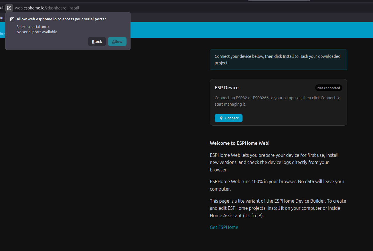

For both windows and LinuxMint, you will also need to give the web browsers permission to allow the the ESPHome GUI flasher site ( https://web.esphome.io/ ) to work with the usb uart flasher.

According to posted protocol, this should find & join to Silicon Labs CP2102 USB to UART bridge. This should be included in Linux Mint. lsusb lists this port.
Dummy :woozy_face: Last couple posts, I’ve been trying to execute esphome web using Firefox. Switched back to Google Chrome. Now I find the Silicon Labs CP2102 again, but cannot proceed further.

ESPHome Web loads fine. Select ‘connect’ (for ESP Device). Select CP2101 USB to UART Bridge Controller (ttyUSB0). Connection confirmed. Select ‘Prepare for first use’. Select ‘Install’ while depressing ‘boot’ button. ‘Installation Failed’.
At best (in my hands) this installation process seems to be hit or miss (mostly miss). Additional suggestions appreciated.
