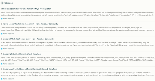

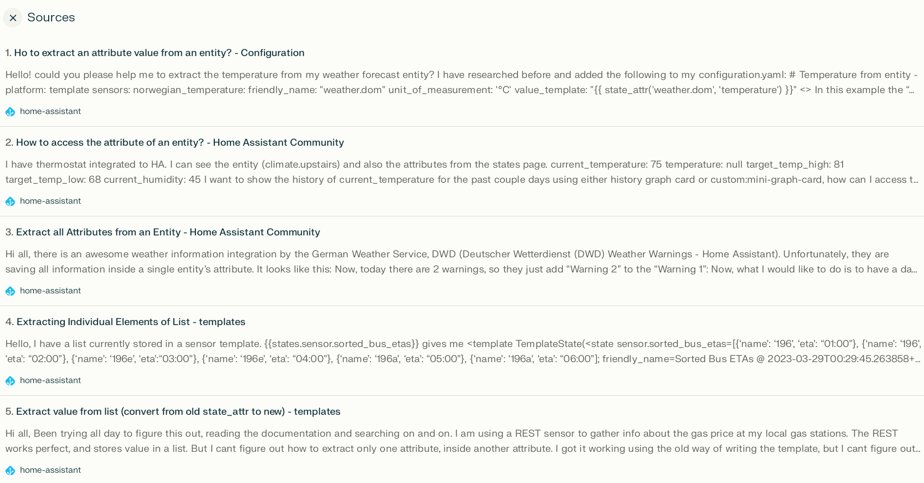

Choose an AI that shows its sources
Perplexity is a good example. This uses an LLM to interpret your question, carries out a web search, then uses the LLM again to construct an answer. Its responses are annotated and it displays a list of sources.
You’ll notice that most of them are from this forum. You could have searched here.

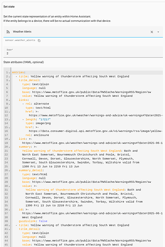

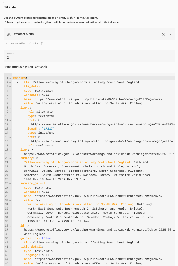

The weather alert entity is sensor.weather_alerts. Its attributes are:
entries:
  - title: Yellow warning of thunderstorm affecting South West England
    title_detail:
      type: text/plain
      language: null
      base: https://www.metoffice.gov.uk/public/data/PWSCache/WarningsRSS/Region/sw
      value: Yellow warning of thunderstorm affecting South West England
    links:
      - rel: alternate
        type: text/html
        href: >-
          https://www.metoffice.gov.uk/weather/warnings-and-advice/uk-warnings#?date=2025-06-13&id=c888f83d-1a97-42f5-8643-a89c060dedf6&referrer=rss
      - length: "17217"
        type: image/png
        href: >-
          https://data.consumer-digital.api.metoffice.gov.uk/v1/warnings/rss/image/yellow-thunderstorm.png
        rel: enclosure
    link: >-
    summary: >-
      Yellow warning of thunderstorm affecting South West England: Bath and
      North East Somerset, Bournemouth Christchurch and Poole, Bristol,
      Cornwall, Devon, Dorset, Gloucestershire, North Somerset, Plymouth,
      Somerset, South Gloucestershire, Swindon, Torbay, Wiltshire valid from
      1300 Fri 13 Jun to 2259 Fri 13 Jun
    summary_detail:
      type: text/html
      language: null
      value: >-
      https://www.metoffice.gov.uk/weather/warnings-and-advice/uk-warnings#?date=2025-06-13&id=c888f83d-1a97-42f5-8643-a89c060dedf6&referrer=rss&region=South
      West England
    guidislink: false
I want to use the summary attribute.

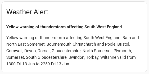

Home Assistant Markdown Card for Weather Alert Summary
To display the summary from your sensor.weather_alerts entity in a Markdown card, use Home Assistant’s templating. Here’s a concise example:
text
type: markdown
title: Weather Alert
content: >
  {% if state_attr('sensor.weather_alerts', 'entries') %}
    **{{ state_attr('sensor.weather_alerts', 'entries')[0].title }}**
    {{ state_attr('sensor.weather_alerts', 'entries')[0].summary }}
  {% else %}
    No weather alerts.
  {% endif %}
  • This will show the title and summary of the first weather alert.
  • If there are no alerts, it displays “No weather alerts.”
  • You can adjust the index [0] to show other alerts if needed.
This approach uses Home Assistant’s Jinja2 templating, which is fully supported in Markdown cards for attribute access and formatting.
And this is what it looks like…
