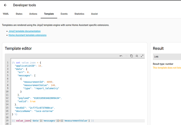

I have one sensor that publishes (trough a Lorawan gateway) an mqtt message like this :
  "applicationID": 15,
  "data": {
    "err": 0,
    "messages": [
        "measurementId": 4099,
        "measurementValue": 146,
        "type": "report_telemetry"
    "payload": "010310503A02009A34",
    "valid": true
  "devEUI": "2cf7f1c0737000ca",
  "deviceName": "luce-esterna"
and I created one sensor in Home Assistant in this way
mqtt:
  sensor:
    - name: "luce esterna"
      state_topic: "milesight/luce"
      value_template: "{{ value_json.measurementValue }}"
      qos: 0
      unit_of_measurement: "Lux"
but this sensor gives no value.
What is wrong ?

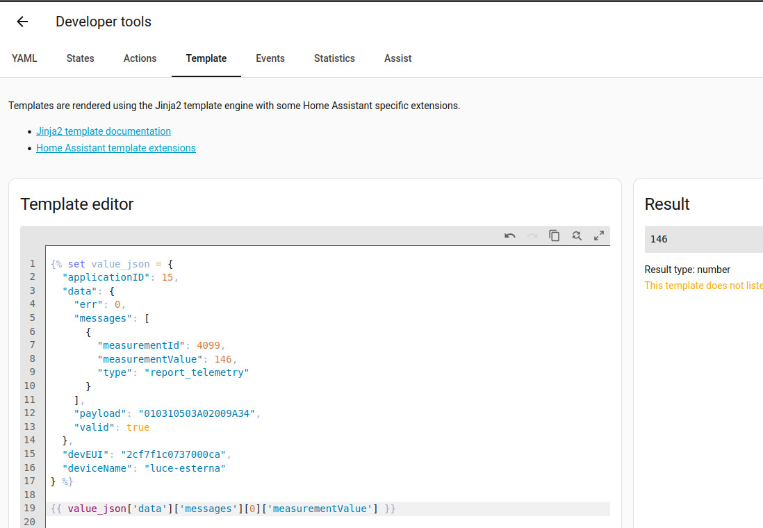

Use:
value_template: "{{ value_json['data']['messages'][0]['measurementValue'] }}"
Try it out in the Template Editor:
The value you want is nested inside:
  • the data dictionary, then
  • the messages list,
  • in the first (index 0) item,
  • under the measurementValue key.
Also, Lux is usually abbreviated as lx.
@Troon It works, thank You very much for the solution and also the explanation (so I understand also the concepts)
