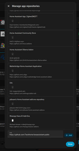

After that I removed the custom URL from the screen where we add custom repositories (not HACS since it’s an add-on), but I couldn’t add the URL again. The button didn’t work.

EDIT: the problem happens when I remove it, close the screen, open again, and try to add again.
EDIT: it wasn’t related to saving or not the data. I just remove the custom URL, click close, open again and try to add and it doesn’t work.
