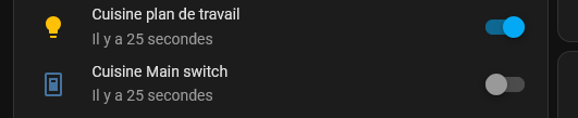

For example, the second switch (bottom) is the main switch that I have associated with a button (mistake).
Instead I need to associate the first one (1 channel of the RGBW controller).
I can control channels (lights) from HA.

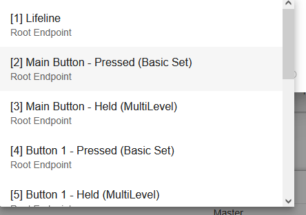

But if you just have a button, you’d select the group and see what options are available in the group. E.g. Here’s what my scene controller options look like
there’s many more if I scroll down.

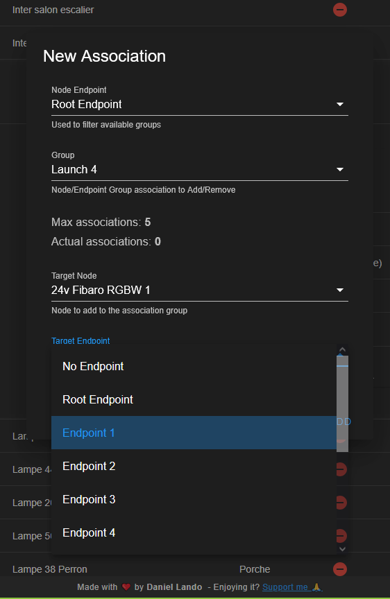

If I try to add an association to the last button, should I do it like that ?
But, my device has 8 buttons, I see only 4 “launch”.
I click on ADD but nothing append.

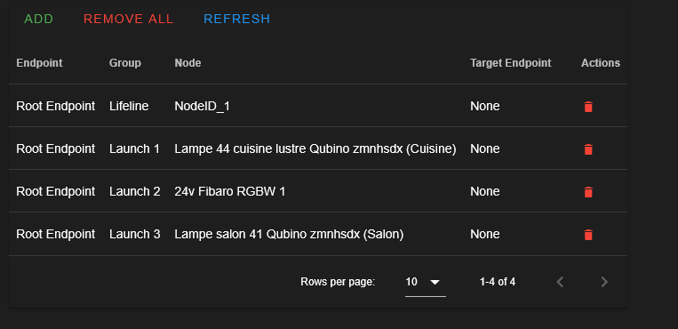

This is the current stat of my device of 8 buttons :
I want to delete the Launch 2, but here too, nothing append when I click on the delete button.
