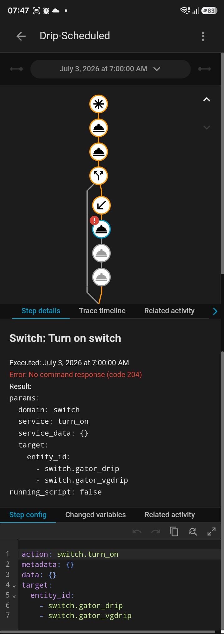

I moved to the new matter js (through 9.0.4) integration and seem to be facing an issue - so wanted to check if anyone has seen something similar.
The problem I'm seeing is if I try to turn on multiple target entities in a single turn_on action. When an automation encounters this, it actually turns on the entities but returns an "Error: No command response (code 204)" and the automation stops.
The automation runs ok if I change it to separate action blocks with one entity each. If I restore the previous (non js) version of matter, the multiple entites automation runs ok.
Any pointers?
