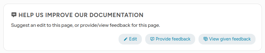

If you feel the documentation ought to be improved, everyone is free to submit modifications. At the bottom of every documentation page you’ll find this:
