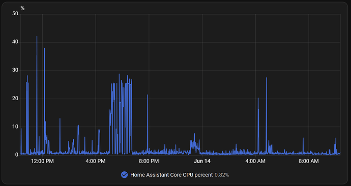

Problem w irregular stalls, tried to troubleshoot. Might installing on NEW N100 solve the issue?
It's all about delay. One moment dashboard loads in a flash. Then 30 seconds. Motion detectors and lights of different protocols and manufacturers. Sometimes instantaneous. Sometime 10 seconds.
CPU often at 20 percent which is gone. But sometimes 70 without backups or anything special running. Memory never an issue. Drive space not an issue.
Logs show nothing. Disabled frigate cause I thought that might be it. No difference. Strong Omada network. Modern coordinators, Zooz and SLZB for z2m. Top notch hardware. Using HAOS 2026.6. Problems probably started about 6 months ago but it was insidious so I don't really know the trigger. I just can't detect a pattern.
I bought a new N100 with 26gb and 500gb, identical to my HA box. I'm thinking of installing HA and restoring backup.
Does this strategy have much chance of success?
Which is?

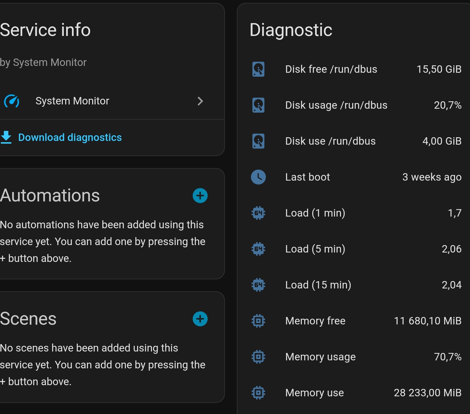

CPU is just only part of your indication of load. You'll need to monitor your 1m,5m, 15m load. If those are ' high' for you number of cores you have IO wait times which can come from anywhere
Sor for example, my 6 core cpu not breaking sweat at 12 -20% load, still had bad times with 4.5 1m load. Any event from/to ZHA or zwave just slowed down.

Install system monitor integration too then
Very good stuff to start with , without starting deep dive into ssh :slight_smile:
