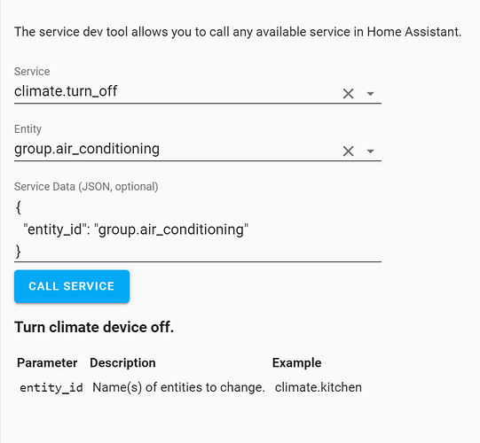

In addition, I have tested the actions from Developer Tools and they worked.

did you go to the service page and select light.turn_on? No groups are displayed clicking the entity field, at least not in my 2 HA instances.
if the group would be a light group Group - Home Assistant the entity would still be light, and the service would still need to be light.turn_on. You have discovered a bug here :wink:
This is for the air condition groups
As for the light group is not there(it was removed from some point) but it works.
You can type it manually.
