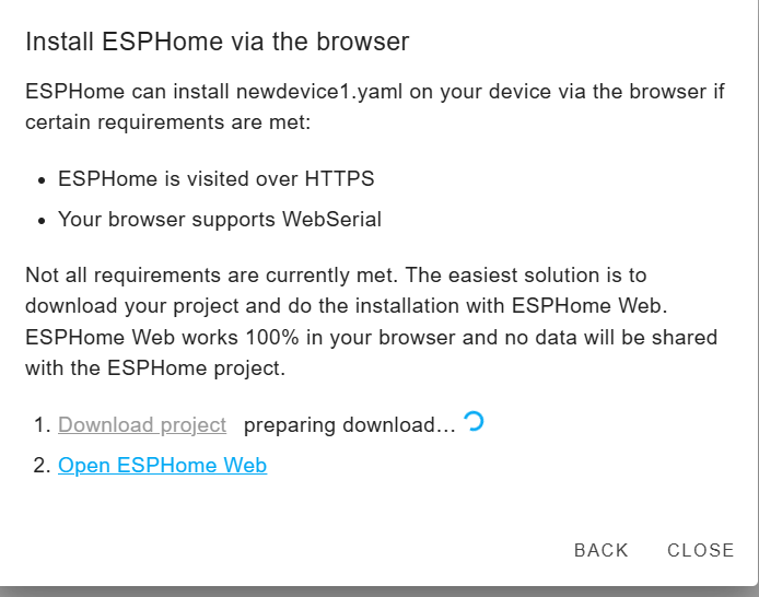

Select ESP3C3:
INSTALL:
Plug into the computer:
Press Download project:
Press ESPHome web:
Press CONNECT:
Press…
Press Prepare… PressINSTALL:
Press CLOSE:
What have I done wrong?
The hardware works fine when programmed with Arduino IDE 2.3.4 for testing the WiFi - Works fine -
-Best Aksel
