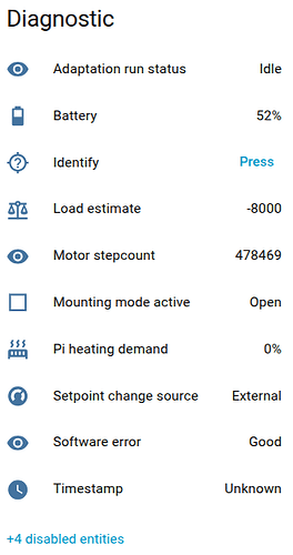

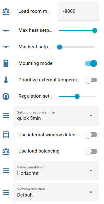

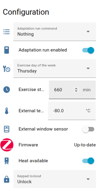

To the op, can you see in the logs what happens when you send the command to your TRV? And can you post a screenshot of the device page with all the settings for the TRV?
That looks pretty much the same as mine (that work as expected). So no clues in there for me. I was thinking maybe the response time was very slow or something but no.

Especially the PI heating demand value should be interesting to watch in logs or history. This parameter should more or less correspond to the motor position. Generally it should start moving relatively soon (tens of seconds tonminutes) after you change the setpoint.
The problem exists not only in the morning.
PI heating demand does not change also.
As soon as I turn the knob, in the display I see that the new set point was accepted. And after turning the knob, the motor turns and PI heating demand changes.
