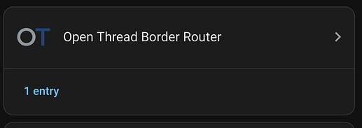

I’ve already tried that. I deleted OTBR, including all data. I set it up again, but I can’t change the network. The Apple network always remains selected. There is a log in the spoiler.

Sounds like you’re referring to the Add-on, which appears to be working, but what you seem to be missing is the Integration, which lets HA control the add-on. Do you have one of these in your list of integrations?
If that’s missing or failed, you might need to add it again. When the Integration and Add-on are working together, your OTBR network should have the circled (i) icon meaning the credentials are known, and the TBR’s three-dot menu gets added functionality like “add to preferred network”.

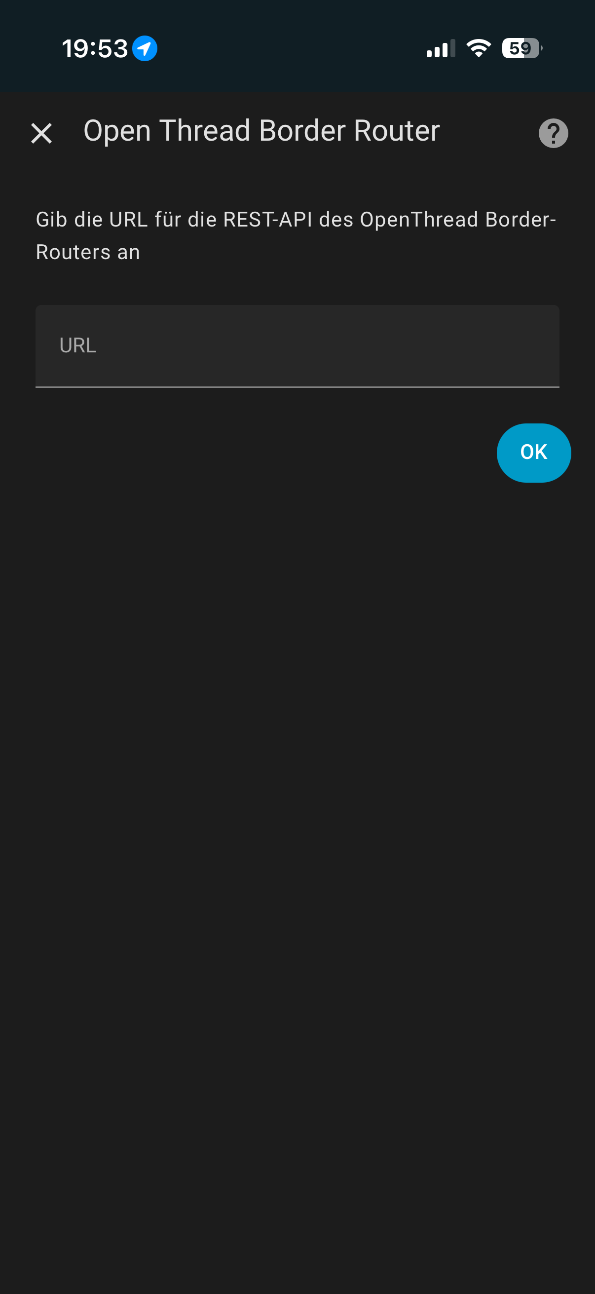

When I want to add the integration, I am asked to specify a URL for the REST API. What should I enter there?
This was what I was referring to earlier about the OTBR Integration…what installation are you using? HAOS?
I use HAOS via VM in Proxmox.
If you are using HAOS, this should be auto-discovered otherwise should be something like http://core-openthread-border-router:8081/

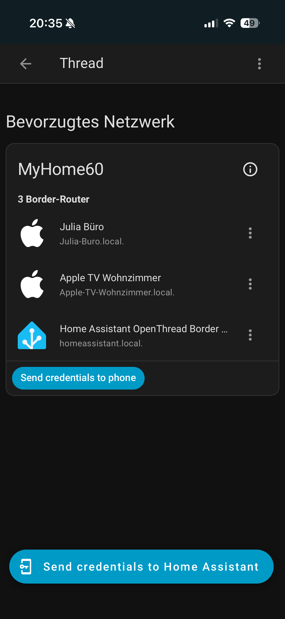

Okay, I did that, and now it looks like this
Now my HA Border router is also listed as a preferred network.
Shouldn’t I still be able to remove the HomePods as preferred networks?
No, you have a single network with three routers — they are all sharing a common set of credentials and forming a strong mesh that provides redundant routes to your wifi subnet, which is usually preferable. You also have the option of commissioning to both Apple Home and HA apps/fabrics (sometimes Apple’s works better for commissioning), since Matter supports multi-fabric control.
If you really want to use OTBR only and not Apple, you can click the three-dot menu and “reset” that router which will form a new network, then you can make that your preferred network, but the new network will lack redundancy, will never have the HomePods because Apple can’t join existing networks, and you won’t be able to use Apple Home for commissioning. Personally I would not recommend this option.
Realize that now that are all one Thread network. There are pros and cons about having multiple TBRs, but before you remove them/unplug them, click on the 3-dots for the HA OTBR and select it for the iOS/Android credentials where you should then see a “key in a phone” icon. Credentials are tied to an TBR when pairing a device. This may actually be a problem because I suspect you have the Thread creds already stored on your iOS device and you gave it to HA so your Creds may already be on your phone stored against an existing Apple TBR. You should be able to delete existing Thread creds in your iOS device using the HA Companion App. and then you can “Send credentials to phone”.
