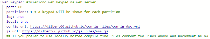

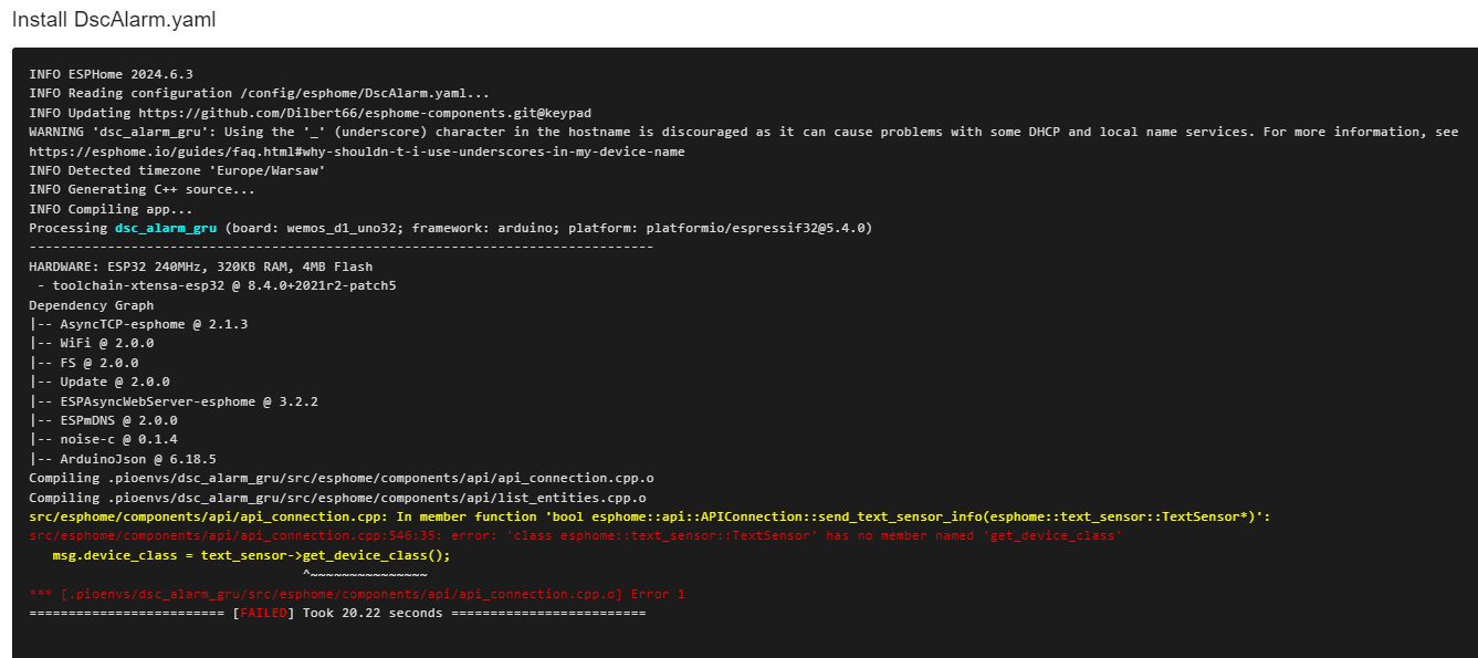

Could anybody help me with DSC installation after ESPHome update? What is wrong that I get such notice:
The source has been updated. In the future you might try and be more specific as to what custom program you are having issues with. Not many people are aware of the program you are using as it’s an external component.
