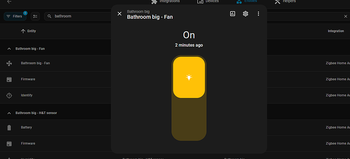

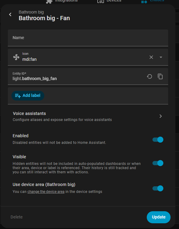

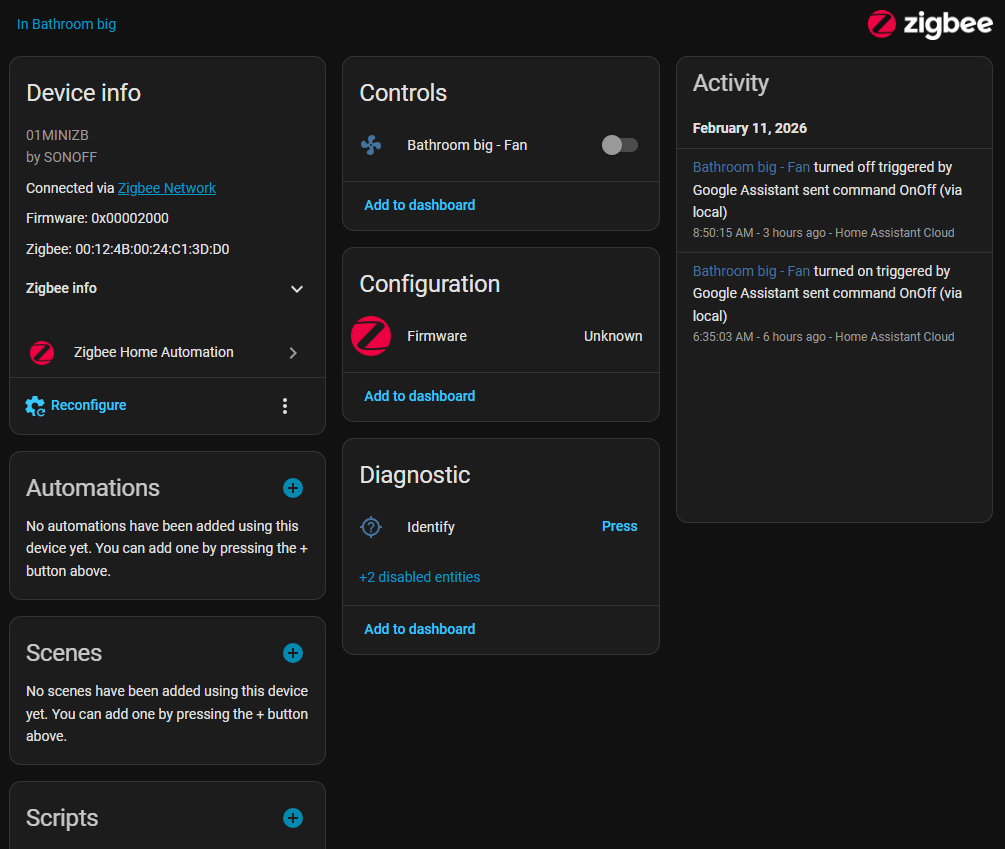

What does the switch actually look like in HA? Go to the device page and click on the entity, take a screen shot, and post it back here.

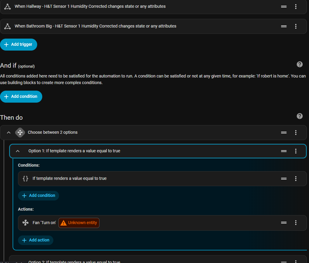

It will likely also help if you can post what you’re using to trigger your automations that are no longer working.

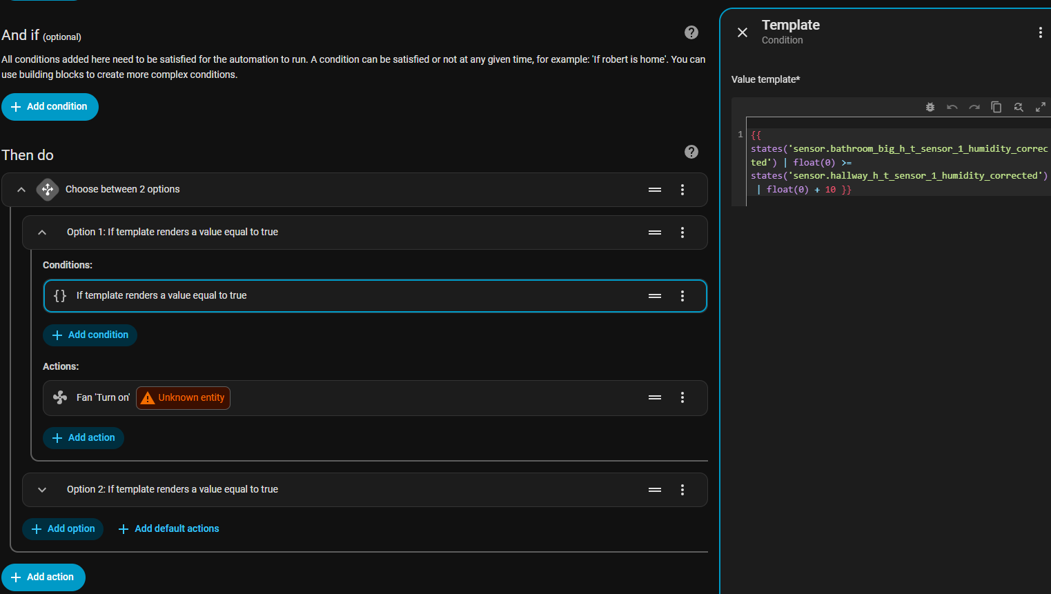

I hope these screenshots help.

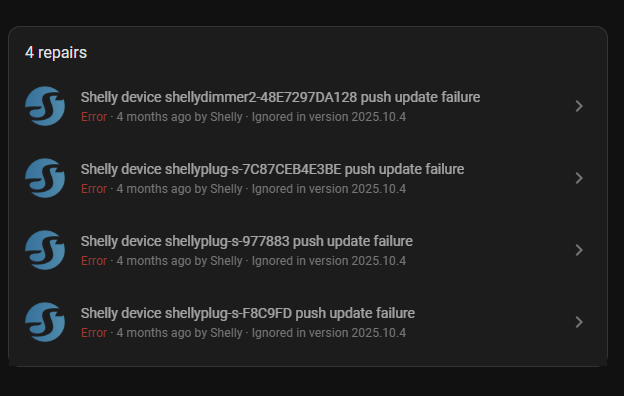

Similar is not equal to the same. Go to Settings > System > Repairs and the click the 3 dot menu in the upper right corner and check ‘Show ignored repairs’, see if you have anything then.

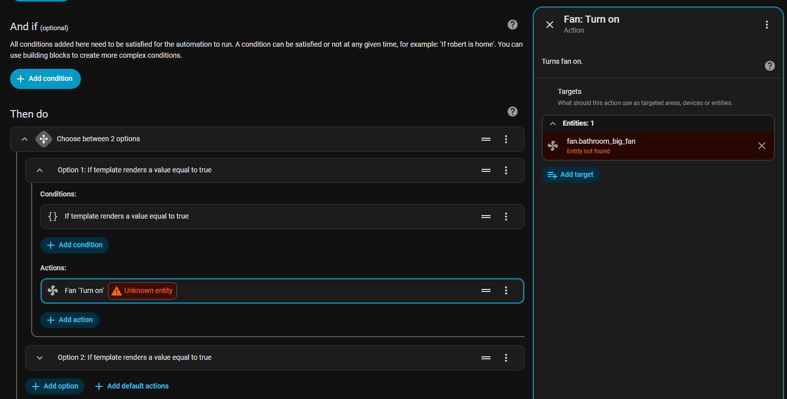

As to your screenshots you stopped just before the important part, what do you get when you click the ‘Actions:’ > Fan ‘turn on’ Unknown entity?

Here you go. The error is gone, it’s not under ignored. Didn’t solve the problem but the error is gone

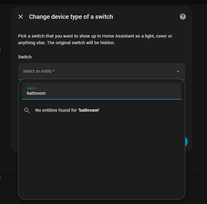

Although a simpler, more maintainable, and UI friendly fix might be to just go to Settings > Devices & services > Helpers then click Create helper in the lower right and use the ‘Change device type of a switch’. Select the switch and choose ‘Fan’ as its new device type. Then use the new ‘fan’ entity in your automations, it’s pretty bullet proof.

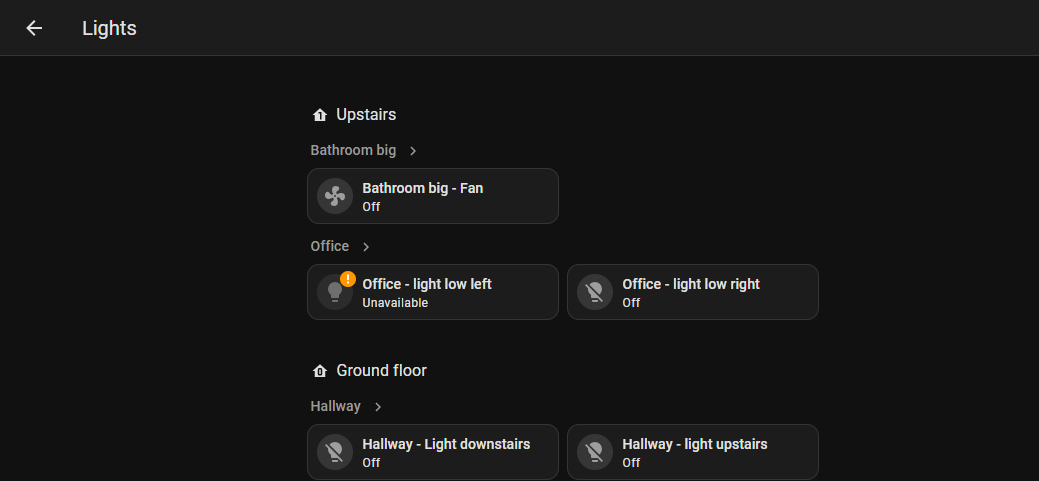

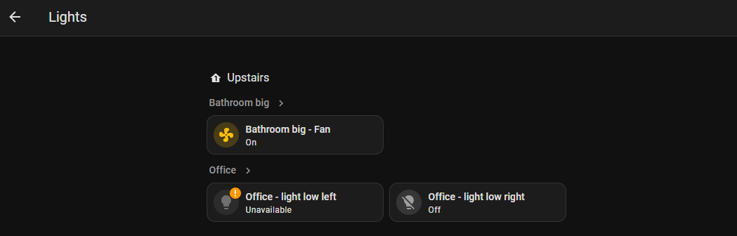

I am bothered about it because it messes up with the audio part so if i turn off the lights, the fan goes off too. quite annoying. it also shows as a fan.

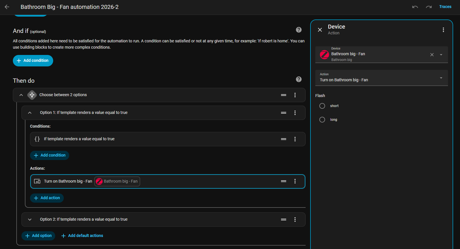

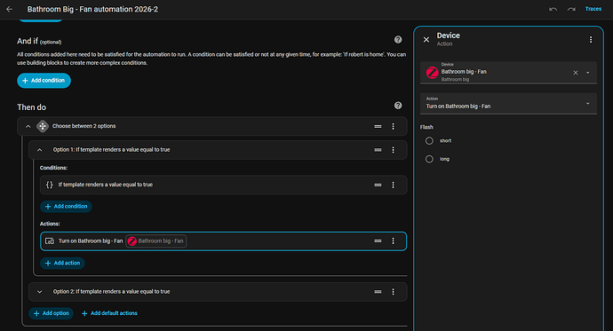

however, i created a new fan automation and that appears to work:
So at least the automation works but when i tell it to turn off the lights, the fan goes off too.
The light entity will still exist but there should also be a fan entity, there must be one as you are using in your automation ? Not sure if you can disable the light now, not sure if that will stop the template fan working
I didn’t realize that was even an option. I just tried to do that to see if that would work and I can’t select it:
Even tried removing the template that Holdestmade gave me and restarted home assistant without any luck
The only think I see is a light. Just readded the config you gave me and restarted home assistant.

@HappyCadaver Pretty sure the ‘Change device type of a switch’ only works for switches and not lights
Right, figured it was worth a shot.
I’m lost here… the modern template entity you provided should work, and there should be one light entity and one fan entity. At that point you should be able to hide the light entity, maybe something in the way zigbee works? I have no experience there.
Well I can use it in the automation now but it’s still a light. It’s confusing to me. I don’t know what to provide as new information. It’s a light and it shouldn’t be one. At least the automation works but it’s not what I hoped it would be.

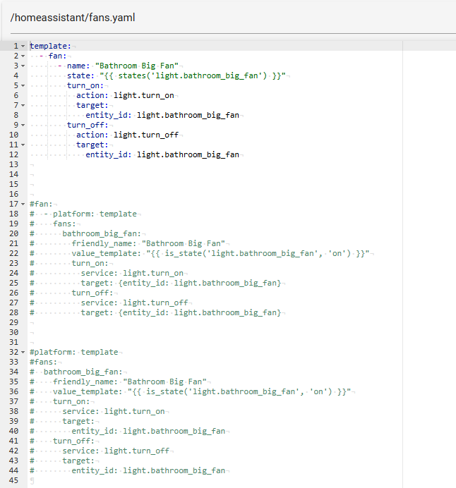

Just to be sure, this is what I have:
I don’t understand how it would turn it into a fan
It won’t turn it into a fan you’ll get a fan entity as well. I’m not sure you have it configured correctly, what is in your config.yaml ? try pasting this straight into config.yaml. or look here and see how to do it in your fans.yaml file

/homeassistant/fans.yaml
What kind of Home Assistant installation are you using? Regardless what this template does is creates a fan entity based on the state of your ‘light’ entity, the light entity will still exist and the fan entity wouldn’t work without it.
Holdestmade beat me to it, but how you’re including this file in configuration.yaml is important here for it to show up as an entity that you can use.

Problem is its classed as a light for Assistant - “turn all the lights off” … think someone mentioned that earlier. With a templated fan you can expose the fan to Assistant and not the light
