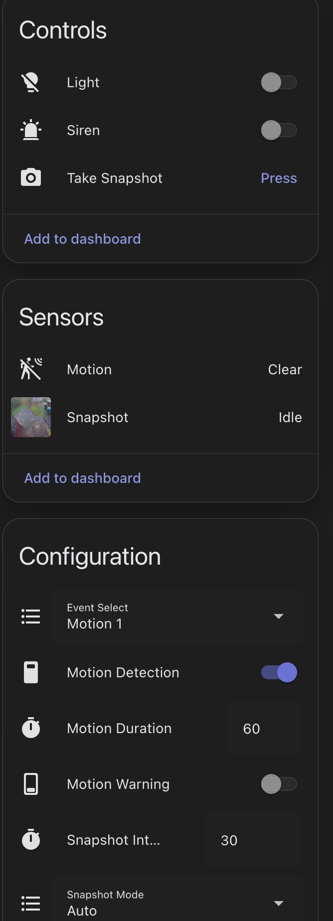

I see the cameras in MQTT no problem like this:

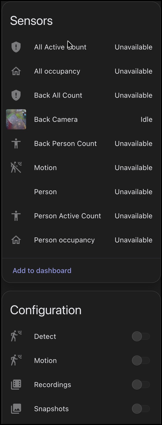

But, in the Frigate add on noting seems to be available bar the stream, like this:
I can’t figure out why Frigate isn’t seeing the MQTT instances when the Frigate MQTT config is setup like this:

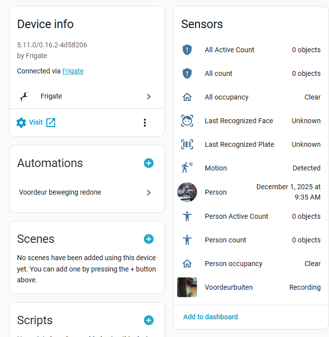

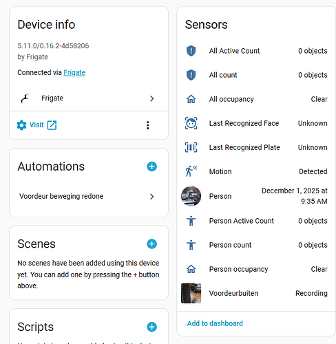

not sure why, but with me, the mqtt delivers everthing to frigate integration:
the mqtt integration doesnt show frigate entities
That’s what I expected to see but, does Frigate show up as a device in MQTT as that doesn’t appear in my list of MQTT things?
