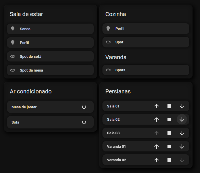

First things first, I’m building a dashboard for my home and learning in the process. I want buttons wrapped in a stylized card, so I found out that my option was to build custom_fields inside a button-card. Here’s how it looks so far:

But the thing is, as soon as I put it inside a custom_field, everything broke. I’ve changed all references like “entity.entity_id” and “entity.state” and things like this to the actual name of the entity, but even simple code like this does not work:
cards:
  - type: custom:button-card
    view_layout:
      grid-area: ac
    name: Ar condicionado
    custom_fields:
      mesa:
        card:
          entity: climate.hvac
          name: Mesa de jantar
          label: "[[[ return states['climate.hvac'].state ]]]"
          show_label: true
          show_icon: false
          tap_action:
            action: call-service
            service: climate.set_hvac_mode
            service-data:
              entity_id: climate.hvac
              hvac_mode: >
                [[[ if (states['climate.hvac'].state == "off") { return "cool";
                } else { return "off"; } ]]]
The HVAC mode won’t change, but the label (that I used as a test tool) shows the right state. Is this an issue with custom_fields? At least ChatGPT told me it’s incompatible.
If that’s the case, what are my options for creating this wrapper without using custom_fields inside the button-card? Layout-card and vertical-stack can’t be stylized… Any help would be greatly appreciated.
