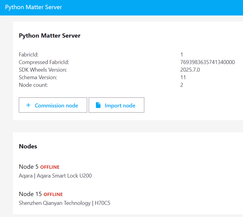

Hi all,
I’m having a damn problem with matter, actually I’m near to solving by trowing away anything… :frowning:
Long story short, I had an Aqara U200, after many retries I’ve been able to pair it via Matter and thread with HA (HA on docker, OTBR on docker, Matter on Docker). Then I bought some Matter-over-wifi christmas lights, and after many retries, again, I’ve been able to pair them with HA. But, after a reboot, all the two matter devices are offline now, and I’m not able to make them work again…
So, hope someone had similar problem and can help me… :frowning:
I’m on a Debian 13 mini Pc, here are my docker compose config, my network interfaces and some other config, Last, my matter docker logs…

Route to what should be the Matter-over-wifi device and ping
$ sudo ip -6 route get 'fe80::9a17:3cff:feea:bf90'
fe80::9a17:3cff:feea:bf90 from :: dev vetheac2be3 proto kernel src fe80::3401:8ff:fe13:3606 metric 256 pref medium
Matter server screenshot
Thanks to anyone that would suggest anything…

And is the result from both the host or inside the container
Update… I completely don’t know how and why, but tonight I decide to remove both the matter device and pair them again… Well, magically they both start working… :no_mouth:I also tried a couple of host pc reboot to see if they continue working and it seems all works good… I’m moved :face_holding_back_tears:
