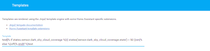

I’m trying to create a template sensor called “gloomy” that test various weather details and summarizes them into a simply on/off sensor that I can use with other automations. I’m running into an issue where I’m getting nothing back from the template dev tool while trying to test my logic/syntax.
I’m trying something like:
{% if states.sensor.dark_sky_cloud_coverage.state > 50 %}on{% else %}off{% endif %}
And I get nothing. Blank. No error or anything. Do I need to use another sensor - is the cloud coverage an attribute of something else?

(In my code, I’m surrounding it with an “if” to make sure the sensor is initialized to make sure I don’t get errors. Simplified for testing in the dev tool)
This doesn’t do anything either. If I put the word “test” before it in the template dev tool, I don’t even see “test” when I have the other template code with it. It’s like it short-circuits the dev tool.
