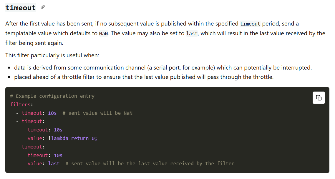

There are two problems. First, the compiler reports a mapping error on the value line. I also tried this way with the sensor:
  - platform: template
    name: "Living Room Motion"
    device_class: motion
    filters:
      - timeout:
          timeout: 10s
          value: false
but that gives an invalid option, though this is the example given in the docs. so my first question is, what is the proper format for this sensor to timeout after 10 seconds and update to false after timeout?

Timeout doesn’t have value option.
And only line ever updates your template sensor is:
has this:
which gives the value options. Is that deprecated and, if so, is there a way to have a template sensor revert to a default value if time passes without an updated state being published?
You are confusing binary sensor and sensor.
