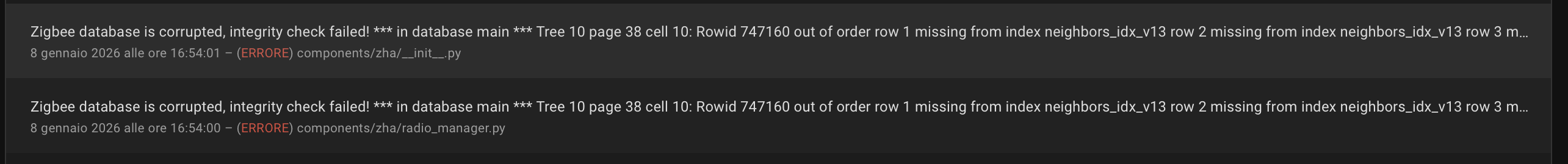

Maybe I understood what my real problems with Zigbee devices could be:
Maybe it happens about 1 time per day in the log.
And this is my log:
Registratore: zigpy.appdb
Fonte: components/zha/init.py:185
Prima occorrenza: 8 gennaio 2026 alle ore 16:54:01 (1 occorrenza)
Ultimo accesso: 8 gennaio 2026 alle ore 16:54:01
Zigbee database is corrupted, integrity check failed! *** in database main *** Tree 10 page 38 cell 10: Rowid 747160 out of order row 1 missing from index neighbors_idx_v13 row 2 missing from index neighbors_idx_v13 row 3 missing from index neighbors_idx_v13 row 4 missing from index neighbors_idx_v13 row 5 missing from index neighbors_idx_v13 row 6 missing from index neighbors_idx_v13 row 7 missing from index neighbors_idx_v13 row 8 missing from index neighbors_idx_v13 row 9 missing from index neighbors_idx_v13 row 10 missing from index neighbors_idx_v13 row 11 missing from index neighbors_idx_v13 row 12 missing from index neighbors_idx_v13 row 13 missing from index neighbors_idx_v13 row 14 missing from index neighbors_idx_v13 row 15 missing from index neighbors_idx_v13 row 16 missing from index neighbors_idx_v13 row 17 missing from index neighbors_idx_v13 row 18 missing from index neighbors_idx_v13 row 19 missing from index neighbors_idx_v13 row 20 missing from index neighbors_idx_v13 row 21 missing from index neighbors_idx_v13 row 22 missing from index neighbors_idx_v13 row 23 missing from index neighbors_idx_v13 row 24 missing from index neighbors_idx_v13 row 25 missing from index neighbors_idx_v13 row 26 missing from index neighbors_idx_v13 row 27 missing from index neighbors_idx_v13 row 28 missing from index neighbors_idx_v13 row 29 missing from index neighbors_idx_v13 row 30 missing from index neighbors_idx_v13 row 31 missing from index neighbors_idx_v13 row 32 missing from index neighbors_idx_v13 row 33 missing from index neighbors_idx_v13 row 34 missing from index neighbors_idx_v13 row 35 missing from index neighbors_idx_v13 row 36 missing from index neighbors_idx_v13 row 37 missing from index neighbors_idx_v13 row 38 missing from index neighbors_idx_v13 row 39 missing from index neighbors_idx_v13 row 40 missing from index neighbors_idx_v13 row 41 missing from index neighbors_idx_v13 row 42 missing from index neighbors_idx_v13 row 43 missing from index neighbors_idx_v13
and is it possibly a serious error?
Do I have to rebuild the entire zigbee network from scratch?

I’d say the answer to both questions is yes, unfortunately.
