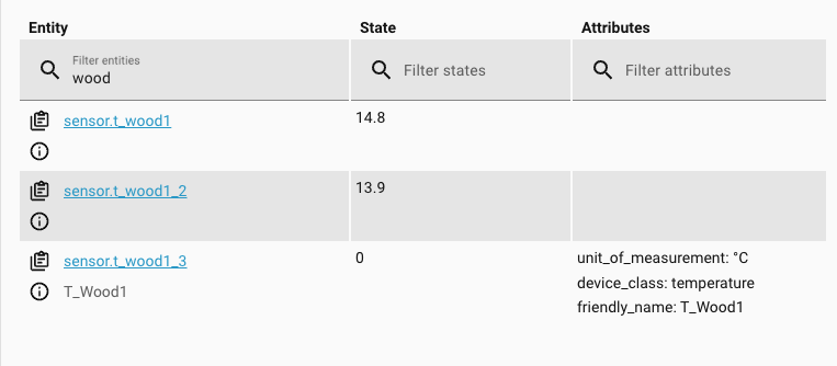

I try to set the state via the REST API:
http://xxxxx:8123/api/states/sensor.t_wood1
requests.post(API_URL, headers=headers, json=datasend)
with datasent is “state: 59.5”
whatever I try the REST API doesn’t use the existing entity created through the template but creates another entity.
like in the image:
How can I avoid this?
Not sure if it’s the actual issue, but in your screenshot, the “real” sensor is sensor.t_wood1_3
Delete your template config, and create the entity via the API.

The way you’re trying to do it is at odds with the design of HA. Sensors are not designed to be overwritten with external “push” values, except for special cases like via the REST API or specific “push” integrations. Template sensors are intended to render their template. If you push a new value, it conflicts with the pre-set template (in your example, "0").
