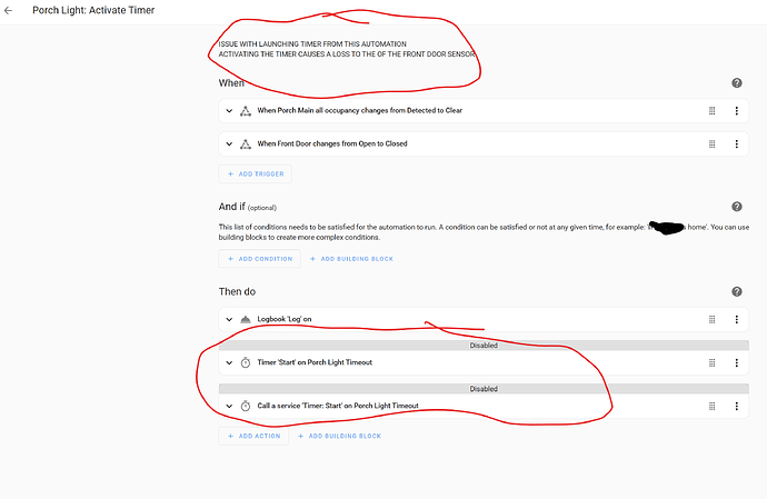

So I’ve got an Aqara door sensor which have been running solid for a year, records open and close events perfectly and hasn’t faulted once until I created an automation
So the problem is that within HA the door sensor is not registered open or close when I disable the automation everything is running smoothly again
The automation itself is simply but I can’t understand why it is having this effect. Has it got anything to do with the ‘timer start action’ ? I’m going to disable that shortly to see

Update…
Disabling the timer seems to not have any adverse effects but why would the timer interfere with the state of the device ?

The problem is not the trigger but the service call to the timer, when enabled I’m losing the states on the door sensor ! How that happens I just do not know
For example here is the difference between the service call enabled and disabled
The event bus sees all transactions correctly, and the automation is triggered correctly

Basically everything works as normal if I disable the timer service call
