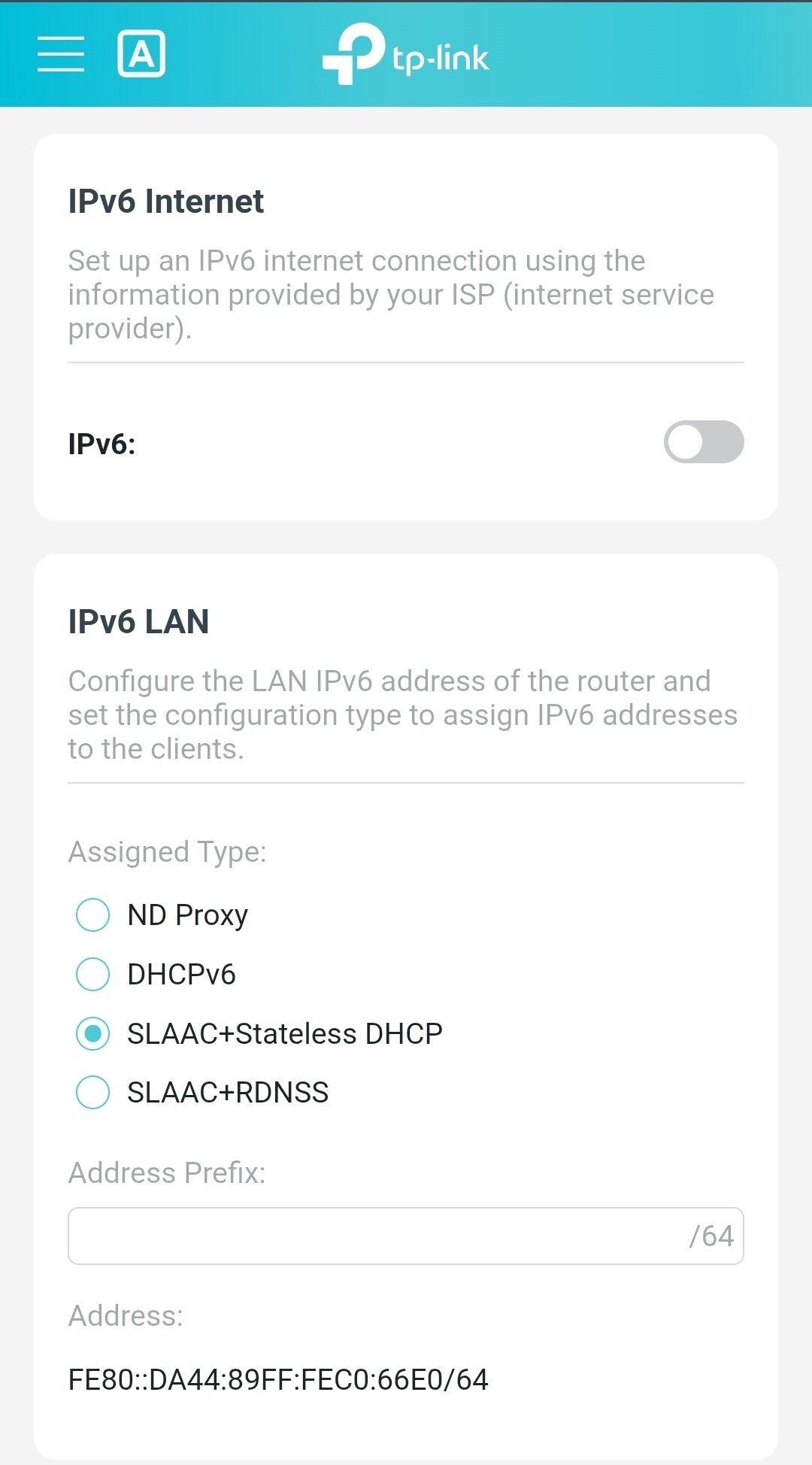

Since people seem to be having ipv6 problems I went in to the router, but I’m all new to ipv6 so I cant tell if its correct.
Router Ipv6 config:

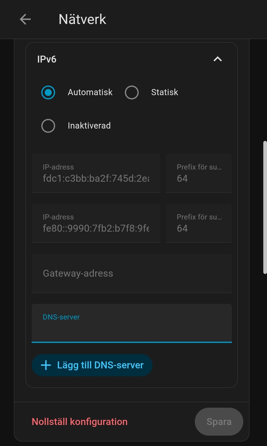

Is IPv6 enabled on your Home Assistant networking?
lstedt
(Lstedt)
January 8, 2026, 5:40pm
3
Yes.
Anything else anybody need to know just ask!
