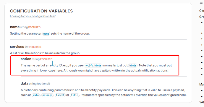

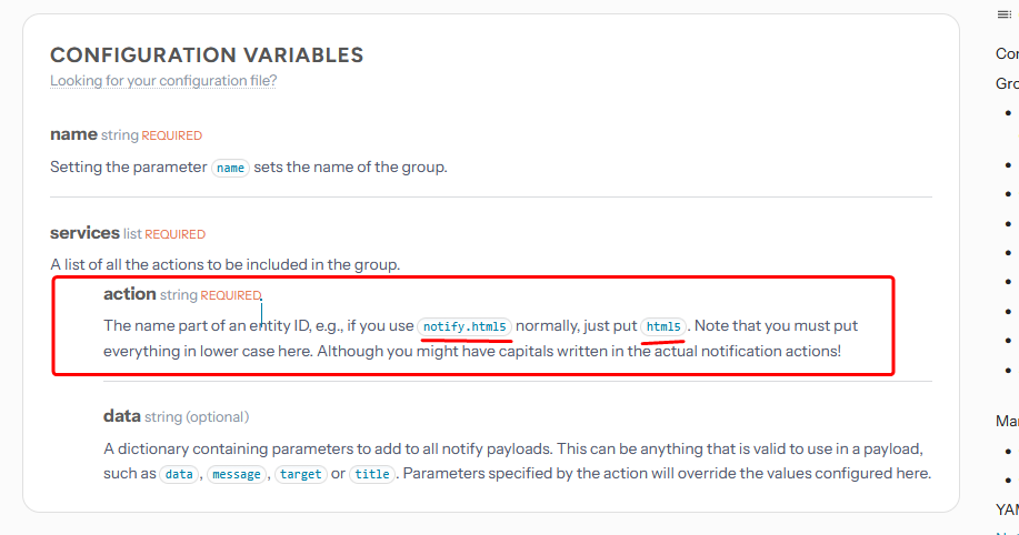

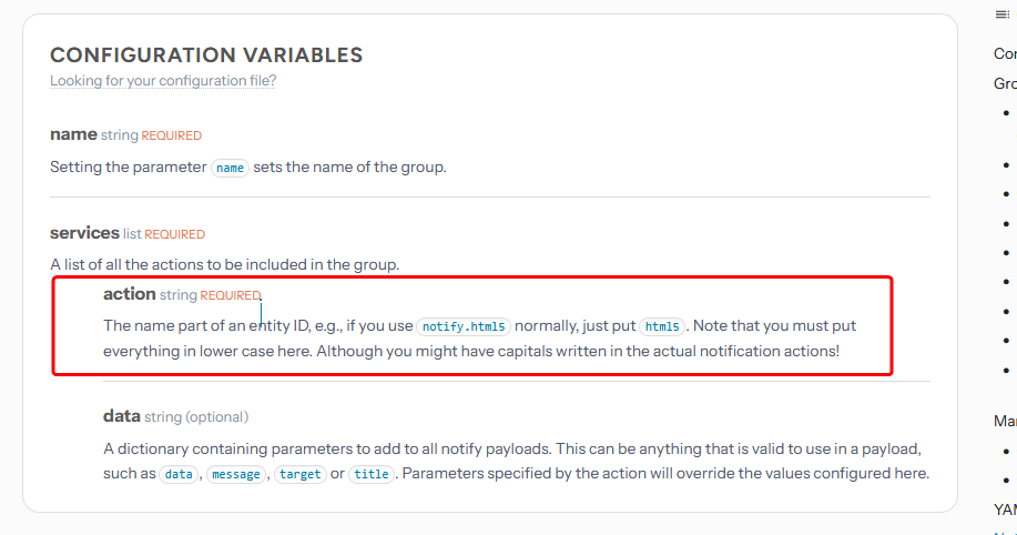

The part that is specific to Notify groups is that you only use the name portion of the action ID, excluding the domain portion. Which is described in the docs, as can be seen in the screenshot Petro posted above.
