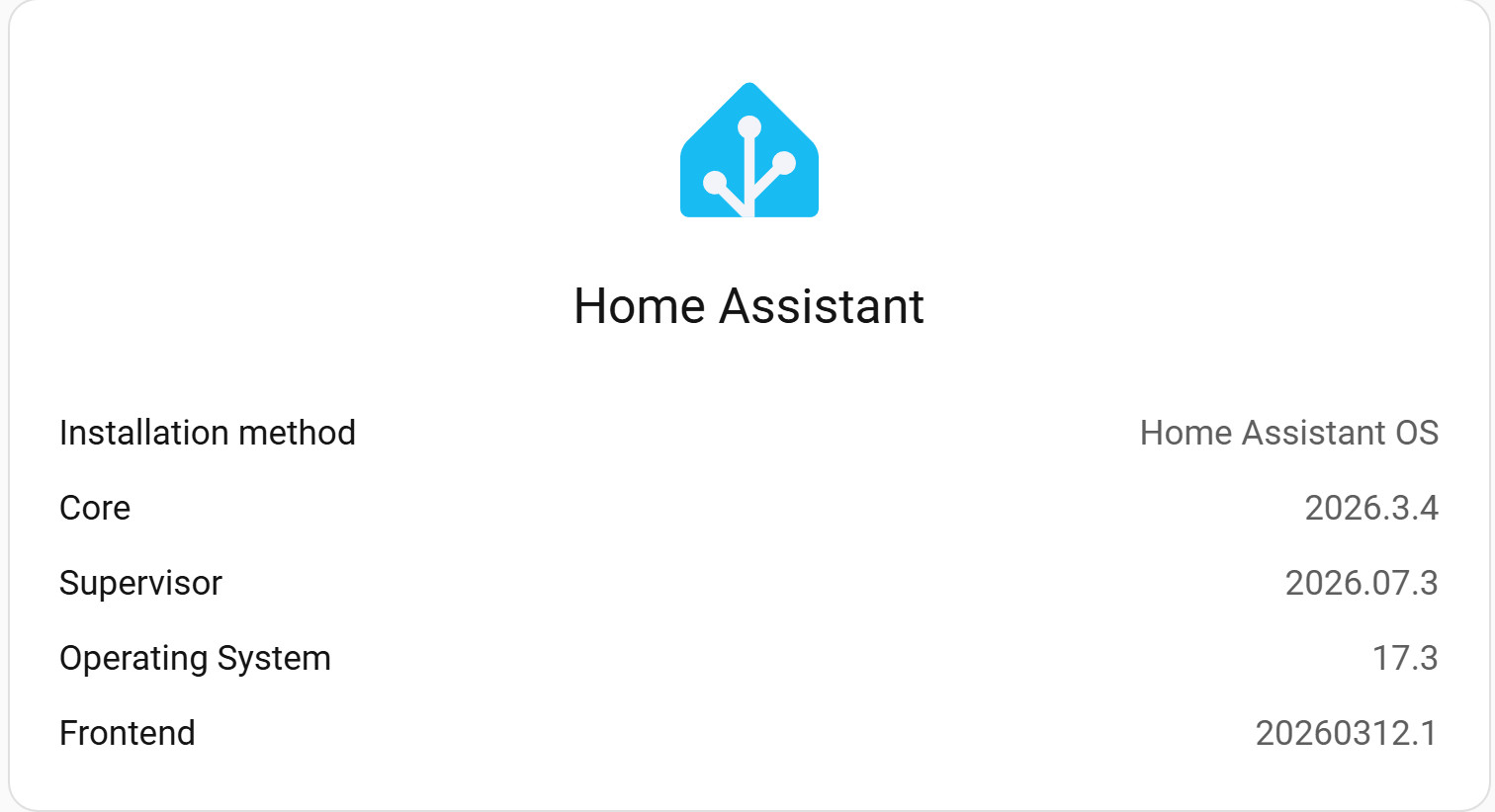

Problems updating Core to anything past 2026.3.4
I appear to be stuck at core version 2026.3.4. Running OS 17.3 Supervised and had been intentionally ignoring core update reminders because . . .
‘it ain’t broke . . .’.
I then succumbed to a reminder to update OS 17.3 to 18, which I did to 18.1.
And then, well, let’s update Core to 2026.7.3 as it politely suggests.
That update failed and resulted in a roll back to 2026.3.4.
I tried a CLI update to Core 2026.4.3 (the next logical rev).
That update failed and rolled back to 2026.3.4.
I rolled back the OS to 17.3 and repeated the above Core updates.
No joy.
Barring a clean install and hoping for the best (and all the time involved . . .), what is one to do?
Running Supervised Hassio OS on an OMV KVM instance, OMV running all latest Debian and Docker updates. Been rock solid for years . . . .
I have Supervisor logs of the events following an update request leading to the subsequent Roll-Back event, as well as Core logs of the corresponding time period. Nothing jumps out at me.
I will proceed to fire up another KVM instance with a fresh install using my backup, but wondered if there were any other words of wisdom . . .

I have done that, running the CLI through SSH. I went to 2026.4x from 2026.3x. It always rolls back to 2026.3
