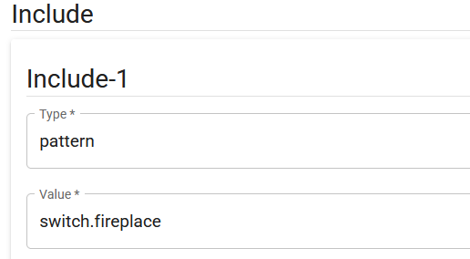

The matter bridge addon posted above works great, although a little annoying to go into the addon UI and set labels of your home assistant devices you want to expose. I am running the OG version, not the new fork which is not under development anymore. Once that is done, go to amazon app to search for new devices

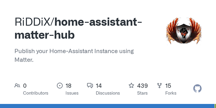

Riddix’s fork of t0bst4r’s abandoned project is now over 700 commits ahead. In other words, it contains hundreds of bug fixes and enhancements. If assigning labels is not to your liking, it offers other selection methods.
FWIW, I switched to Riddix’s fork a few days after t0bst4r released the final version. All 45 devices were transfered without any problems.
EDIT
Anyone wishing to use the Emulated Hue integration in order to Alexa-enable their lights should first give Matter Hub serious consideration.
