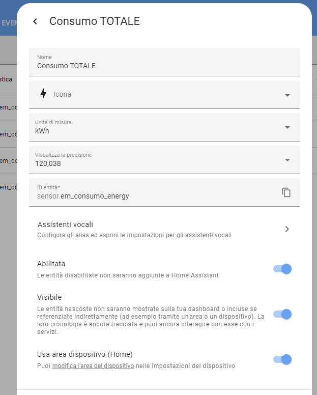

Show your current config and the history graphs for the two source sensors.
Here the two source sensors
And there is another problem… the “immissione” sensor is ALWAYS 0
