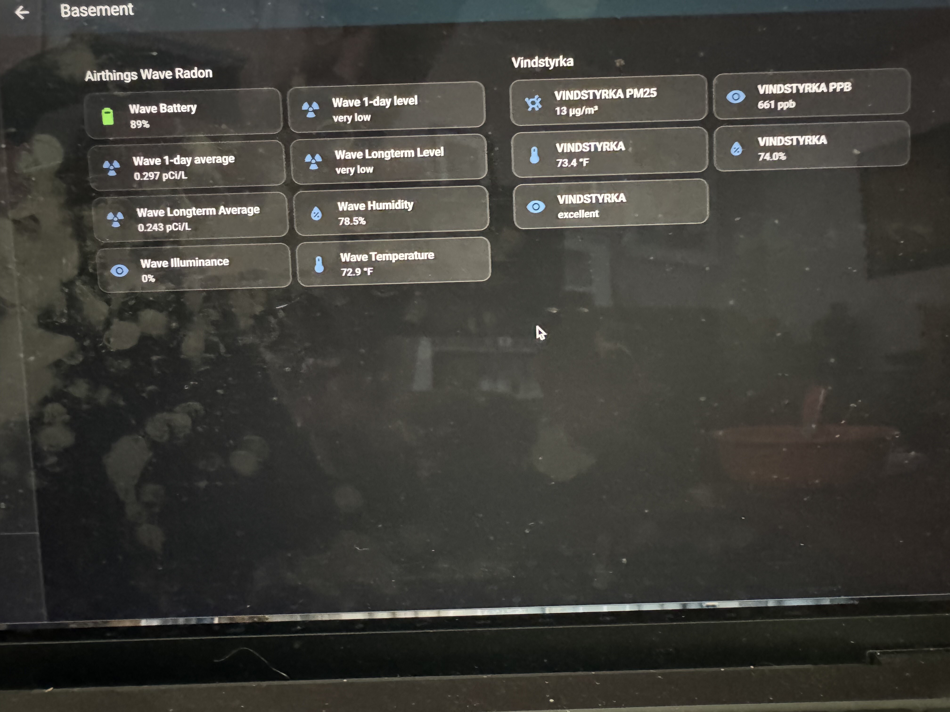

I have been using homebridge and Apple Homekit for a couple years now without problems. I decided to try Home Assistant and so far I like it but I am have a weird problem. I am running two air quality monitors 1. Airthings Wave Radon over bluetooth connected to home assistant and 2. Ikea’s Vindstyrka over Zigbee connected to Homeassistant via a Conbee II. This setup gives me a lot of cool data to play with including tVOC and PM2.5 levels along with temp and humidity readings from both devices. This scenario worked flawlessly using homebridge and Homekit presenting all the data nicely with remote access in homekit. But homeassistant with the home kit bridge setup I only get temp, humidity, from both devices and the PM2.5 data from the Vindstyrka. All the data is in Home Assistant but in Home Kit all the interesting tVOC data is missing. I have selected bringing in all domains with Home Bridge Integration Install. Is this a known issue any suggestions? Obviously I am a novice only a couple days experience with Home Assistant. Also I have completly removed all 3rd party bridges from Home Kit before adding HA ‘Homekit Bridge’.

I can see all the data in home assistant, but it’s not all coming through home kit bridge into apple home kit.

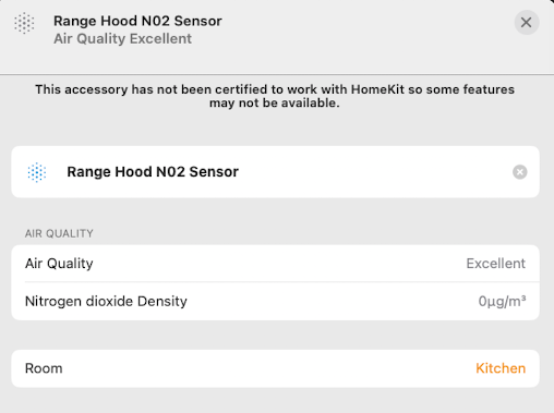

For example, I have a nitrogen dioxide sensor that is visible in HomeKit. In the Developer Tools / States browser, I can see that the entity has the following attributes:
state_class: measurement
unit_of_measurement: μg/m³
device_class: nitrogen_dioxide
friendly_name: nitrogen_dioxide_kitchen
This appears in Apple Home as an air quality sensor (“Excellent”) which you can drill into for the current value:
