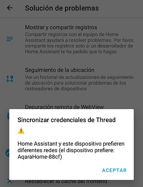

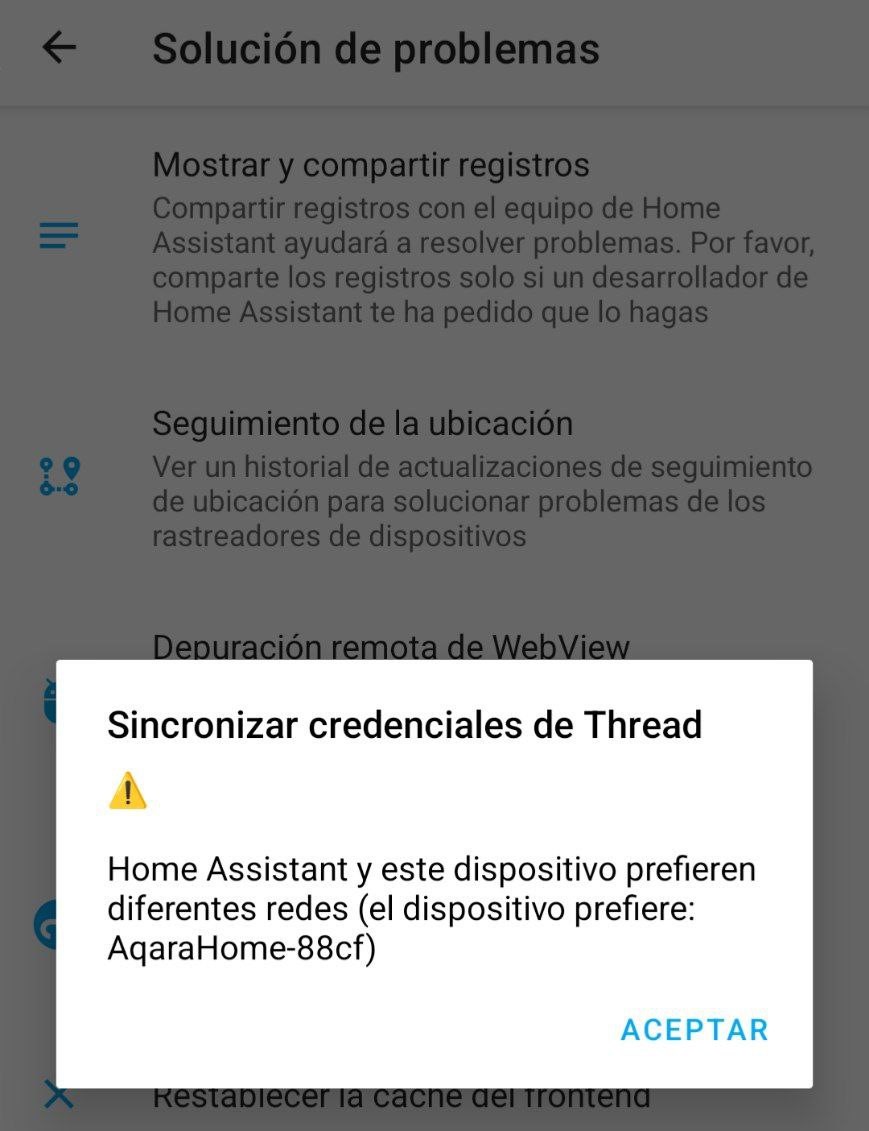

To be perfectly clear, Google Home, which is responsible for linking with Home Assistant Companion, for some reason, and despite the fact that (and after many attempts) the HA app is properly synchronized with the Thread credentials, won’t leave the Aqara’s old network. So, if there was a possibility of adding the device, this completely eliminates it. Alexa has the same problem; it stays on that network, and even if you try to connect it to the Aqara, it asks for credentials and a network key that I can’t find anywhere.
The error I managed to get through trial and error was to make HA companion have the same preferred network as HA server, but this doesn’t help Google Home to make the connection since it’s still stuck on the old Aqara network.

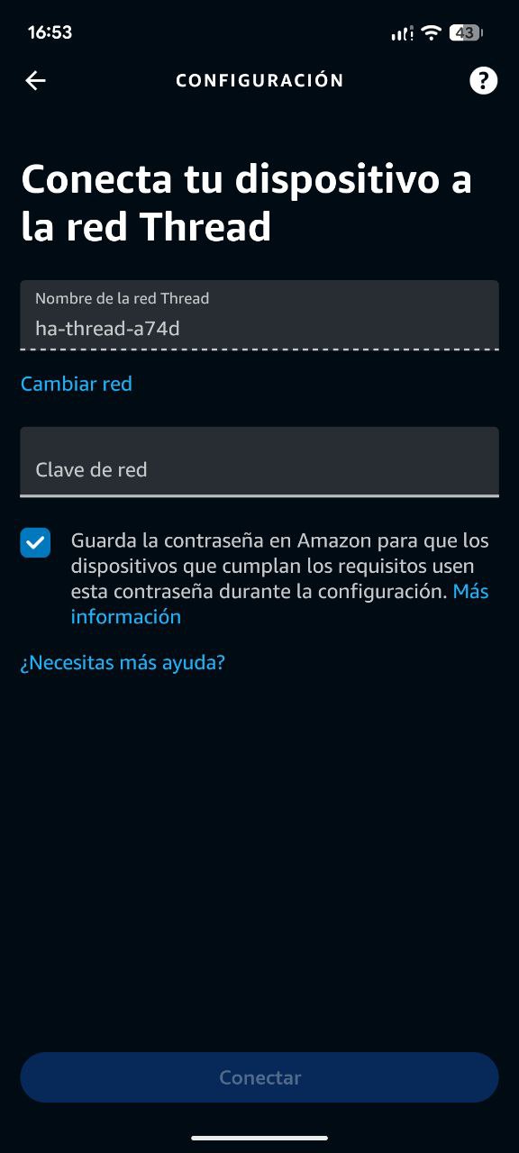

Alexa is seeing the network created by the border router (ZBT-2), but it’s asking for credentials that you can’t easily obtain; it doesn’t make sense. The same thing happened with the Aqara.

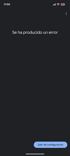

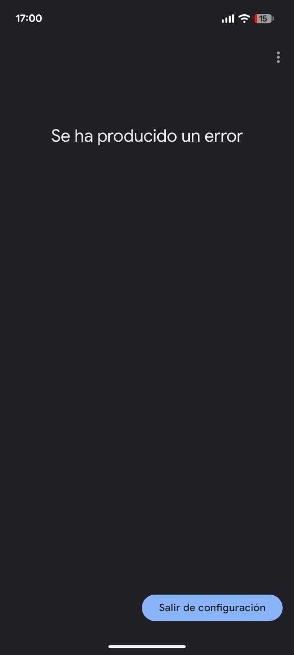

All this so that when I had Aqara, the most I got (not counting the Aqara App) was this error message:
I’m convinced that if Google Home switched to the ZBT-2 network, it would get the same error.
