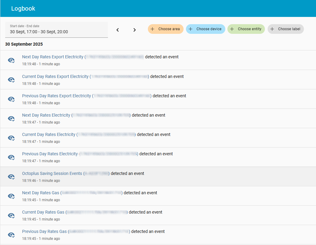

I believe the incoming rates are updating correctly, as I see this in the logbook:
Never got this working in any of the ways above, so I did it with a periodic polling trigger every minute that checks the rates. Also, once things started triggering, I could see the value is in £ and not p, so needed 0.03 and not 3 to get 3 pence.
Is this the most efficient I can hope for, or is there any improvements? At least it’s working. I guess i’m not overly happy at using polling, I would rather it was event driven for performance and power management reasons.
