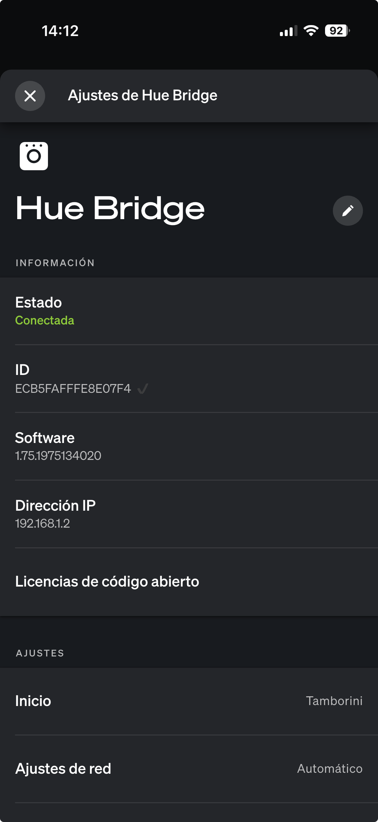

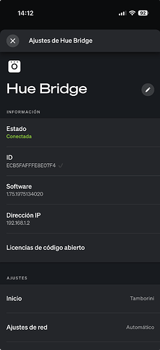

Integration with Philips Hue Bridge is impossible. It no longer works. It doesn’t even ask me to press the button on the bridge to pair it. The message to enter the Philips Hue IP address appears, I enter the address 192.168.1.2, but I still have no luck.
I test via curl without problems.

I reset the Hue to factory settings without any problems. I think the problem lies with the new version of Home Assistant. Do you have any idea what it could be?
