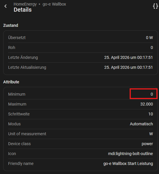

The problem is, that the go-e apiv2 connect doesnt allow me negative values for this parameter (even though the app does support a negative value).
I tryed to manually overwrite this limitation and found the value in the const.py file of the integration. I changed the low limit to -2000 and it also displayed me this in the attributes then. But when writing this value, it still didn’t work.
