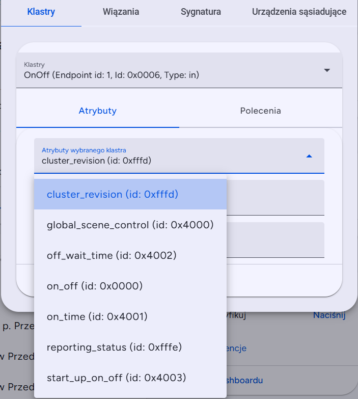

Thanks for the answer, however I’m not sure if I can can configure reporting manually for these - I have such attributes for OnOff:
Unfortunately none of these look like could let me configure the reporting.
